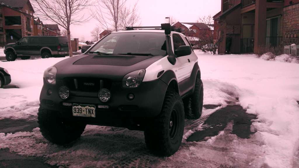

After hours & hours of research I found a snorkel that could fit with little modification. The snorkel is made by Airflow model #S029 for an ISUZU MU (Australian Amigo). The snorkel has already gotten a lot of attention in the two days it's been installed.
Fitment: The shape of the snorkel is perfect for the VX's window frame but the snorkel's base doesn't fit our fender flare as well as I was hoping. Using a heat gun, I reduced the snorkel base contour to fit the VX fender. Additionally, I used foam window seal to fill in the gaps between the snorkel and fender. Lastly, I had to use a heat gun to bend the top of the snorkel so the vent stands up straight.
I still have a little work left on the snorkel... like hooking it up to the air intake
I may still look into having an official Project ZU VX snorkel made but the initial estimates were too pricey. For now, this snorkel is a nice option.
Price: $350 AU + shipping from Australia.
Here's the link where I purchased the snorkel:
www.snorkels.com.au
And here are the pics:
