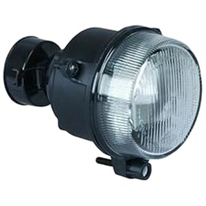

    Closing out my own request in this thread, I was able to get the measurements (roughly, but close enough to count) of those sockets. I'm going to replace the OEM lamps and housings with a pair of true fog lamps.
    (The ones I've purchased are the 80mm 55W H3 Halogen DE Series from Hella.) I plan to disconnect them from the lighting controls on the stalk, and wire them to an Isuzu OEM fog lamp switch to be placed in the fuzzy
    hole blank plate I acquired last year. The other two switch location will also sport OEM fog switches - already acquired - to control two banks of auxiliary lighting: a pair of driver beams mounted to the safari bar, and four
    on the roof - a pair of spots at the inboard position and a pair of floods at the outboard position.
    I love it when a plan comes together. When it begins, I'll be sure to document everything in a fresh thread.

    The lamps I got are the these 80mm babies from Hella:
    Hella's part number is H12186011. Or just search for [Hella 80mm fog] and you'll get plenty of info on them. Plus, I'm angling to swap the bulbs a la Rowhard.

    The lights arrived today.
    If anyone's thinking of getting these same ones, hold off until I can see if they'll work. Turns out, they're NOT 80mm, but more than 90mm at the base, which is the vital measurement. And the centimeter makes a big difference.
    -V
