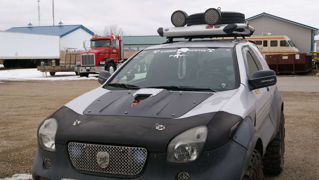

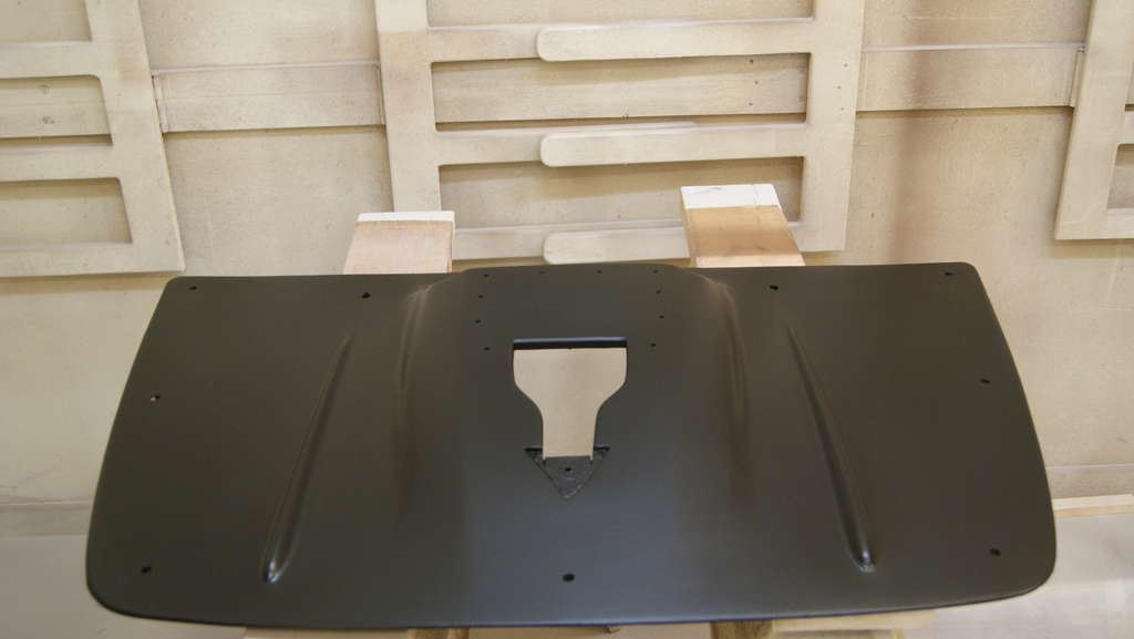

    I'm in the process of re-working the hood scoop/insert...
    My last attempt was less than a stunning success, so I done decided to take a "do-over"
    First off, I always thought my hood scoop was about the right length, fore & aft, but not wide enough to suit my eye.
    Soooooooo...the logical thing to do would be to widen it, yah?...
    I waltzed it by the table saw @ work, then sectioned in a piece of plastic from the underside, bonded together with PC plastic epoxy, held together temp w/ screws, since the holes would be filled in the next few steps.
    As can be seen, after sectioning in the center section, it's been back filled with several layers of FG cloth/resin, then kitty hair.
    BTW...when cleaning old adhesives etc from your project, always have plenty of ventilation...otherwise...
    Anyhoo. @ this point in time, I have it widened by 2", & epoxied to the hood.
    Am starting the build up/blending, using F-G mat & epoxy resin, then gonna sand/smooth everything out with kitty hair, & eventually cover the whole thing in CF.
    Maybe more after tomorrow...
