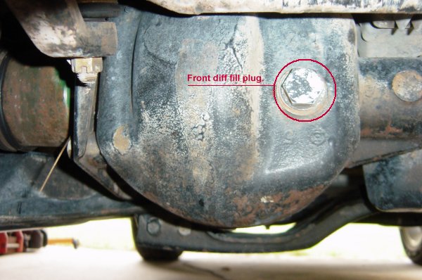

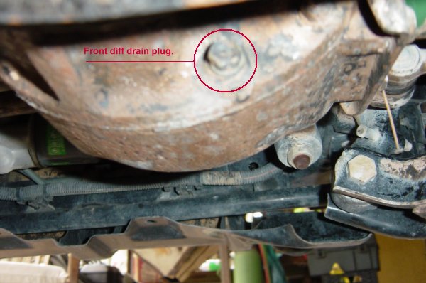

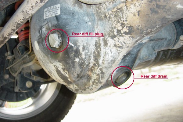

    Okay, here's some (hopefully!) helpful pics of the tranny and diff fill and drain points.
    First, the front diff drain found on the rear of the front diff...
    ...and the front diff fill on the front of the front diff:
    The rear diff drain and fill points as viewed from right-rear corner:

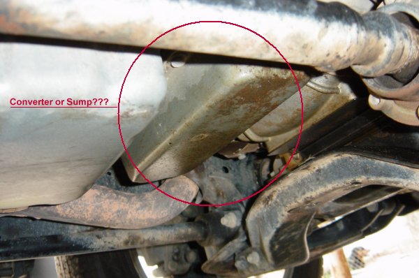

    And last but not least the pan just forward of the main tranny pan, possibly a sump or for the converter (those in the know chime in):
    Again, hope this helps out!

    Mr. Black, you are a gem.. a GEM I say!
    The pics are perfect, and the "other" pan in front of the tranny pan is exactly what I was thinking of.
    I am going to print these pics out and use them to go buy... perfect!!!
