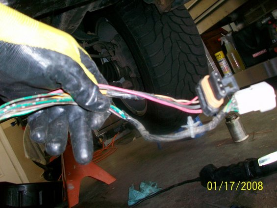

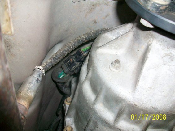

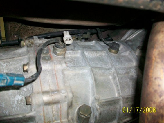

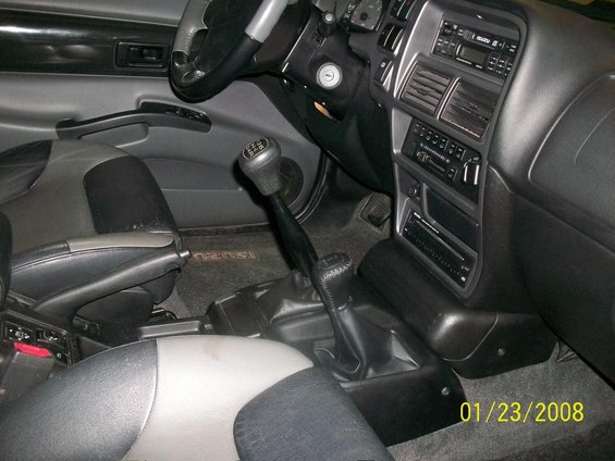

I installed both the clutch and brake pedal from a manual shift Rodeo. It is a little tight in the foot well but I have very long legs. Size 13s might be a challenge I would find a manual Rodeo and check that out, the VX would be the same. Hanging new pedals is straight forward, just a lot of sharp corners to deal with. One headace was getting the security computer(s) remounted out of the way. I ended up velcroing them to the ac housing and it worked out pretty nicely.
