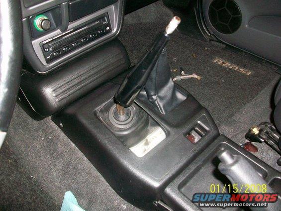

    Can you use the wiring harness from the Trooper? You had to change the ECU, right?
    Also it looks like the manual shifter fits in the VX console, thats a nice easy solution.

    You have to use the harness from the VX due to the wiring for the TOD. Yes, I used the computer from the Trooper.

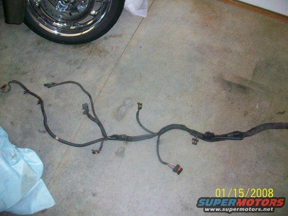

    I have the main harness installed and all the O2 sensors connected. To connect the last O2 I had to spilt the O2 wires out and make a separate housing. The last VX O2 sensor on the passenger side will now be the last sensor on the driver side, this is because we used the Trooper head pipe. I fabbed a heat shield out of the old starter shield. I am pleased it will protect the wiring.
    Here I am separating the O2 wiring from the stock wiring harness...
    Here is where I "Y" the harness...
    Here you can see where I routed the new O2 harness...
    The connection is made above the transfer case...
    The finished install...
