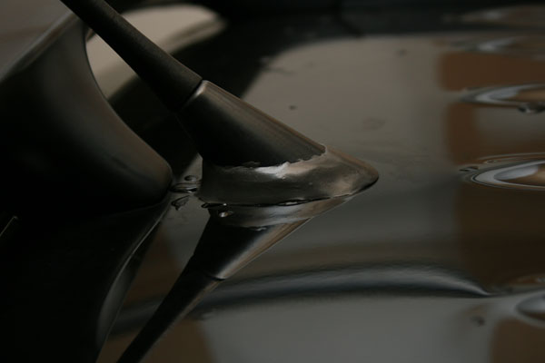

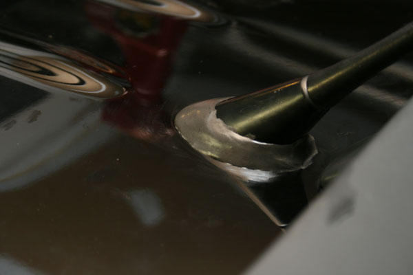

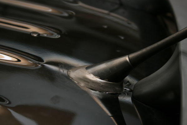

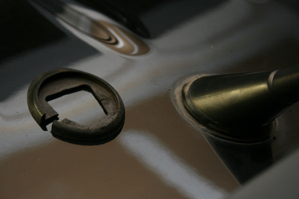

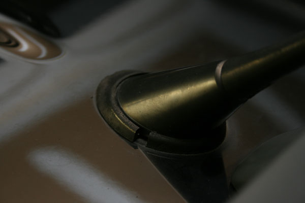

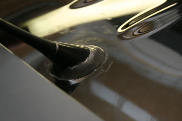

    I "installed" some Sugru over the weekend.
    The process couldnt be easier.
    Its like playdough for about 30 minutes. Then you have to leave it alone to cure for roughly 24 hours.
    I used 2 packs and worked it into a good shape then took some soapy water to give a smoother finish (vs. have finger prints everywhere)
    I am over all pretty impressed with the product. It was a heck of alot cheaper than a new antenna and even easier to install.
    Its a little closer to a faded black, than a black when its all done. It almost matches the rest of the lightly faded roof rails.
    The sugru is heat and cold and UV resistant.
    Here are some pictures.....
    Dry Rotted gasket
    dirty under gasket (CLEAN BEFORE APPLICATION!)
    Immediately after smoothing with soapy water
    After roughly 48 hours and some rain
