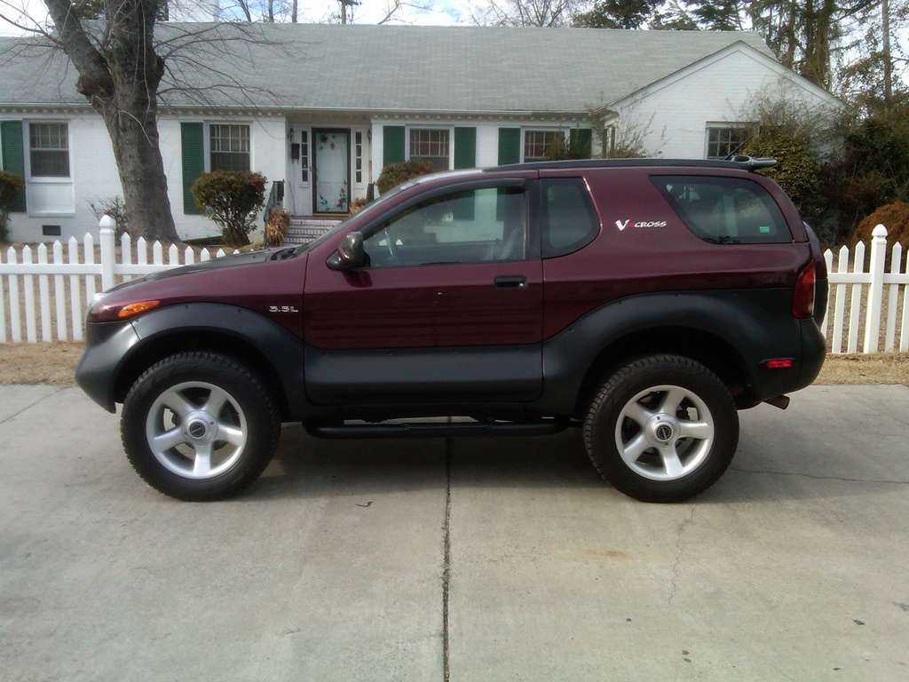

Lol, well since it's the exact same color and has the step bars and the 1.5" Daystar coil spacers it looks EXACTLY like this picture of my old VX:
I didn't have a chance to take pics before I dropped it off at a fellow member's house on Saturday for a little upgrade... more on that to come.
