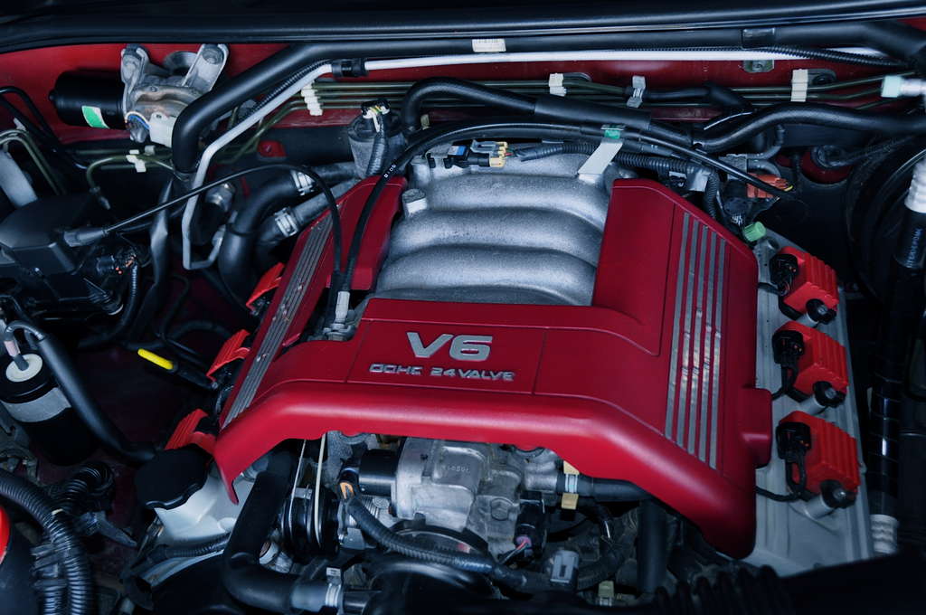

Shows the PCV after the engine cover is removed: **not a VX though**

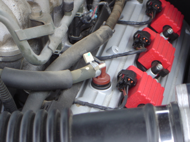

Shows PCV with hose removed:
PCV detached from crankcase, but hose still attached:

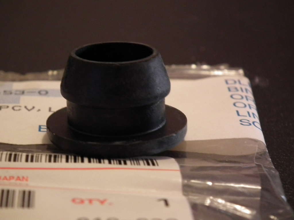

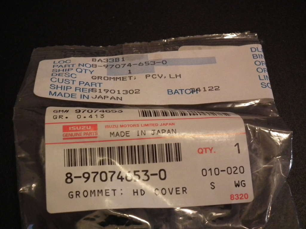

OEM Rubber grommet:
