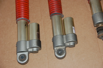

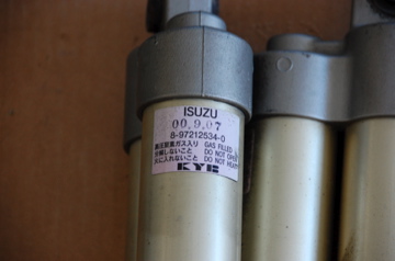

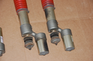

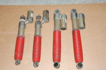

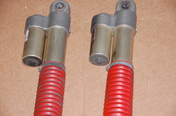

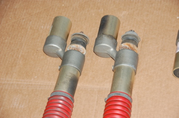

Anyway - the original question was which pieces need to be fixed when the boinging starts. The answer is.... THE SHOCKS!!!!
But if it's just a harsh ride you're talking about then that's normal. If you're getting a lot of brake dive and pogoing then the dampers are no longer damping. If you've still got the OEMs, you might want to try just adding nitrogen. If that doesn't work, they can be rebuilt. If you've got worn out aftermarket shocks then it's time to replace.
