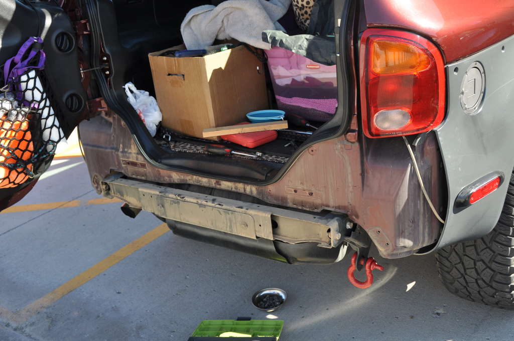

    Somebody correct me if I'm wrong here, but IIRC when LDub took my bumper off there's one or two cladding screws for the rear bumper hidden BEHIND the rear wheel cladding, below the tail; light. I think you have to kind of pry the side cladding up a bit to access these two screws.
    I also think there's a How-To on the forum somewhere....I know there's one for the front bumper, but think there's also one for the rear.

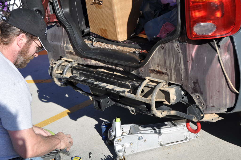

    Here's some pics of my rear off () to give you some reference. See the white tubing thing hanging below my tail lght...the hidden screws are FORWARD of that, behind the side cladding.
    [img]http://www.vehicross.info/gallery/data/500/DSC_4742.JPG[/img

    My VX came with a Curt hitch and it was only held on by four bolts, two each side, through the bottom of the frame rails. Is there another type of Curt hitch I'm unaware of? I know the Tone hitch is a through-the-bumper-cover affair, that requires cutting and fitting...

    Scott, I have the same Curt hitch you do. But putting it on means that the left and right tie down/tow points on the back have to come off, and to get those off everyone says the back cladding needs to come off.
    Jul 2009
    1,226
    OK, so there's the problem! When I took mine off, it didn't require access to the bolt heads. I just hit the nuts with an air impact and the bolts stayed put. They are still there sticking out the bottom of the frame rails.
