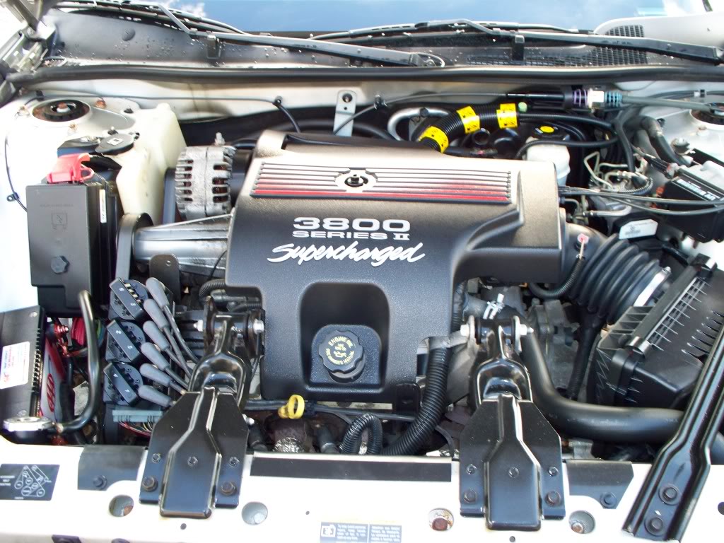

    Here is a 3.8 supercharged. It is transverse mount....Hmmm.

    I forgot that they're traverse mount, what a pain to work on. I remember it was even difficult to change the serpentine belt because everything is stuffed into the side of the engine bay.

    How do they do this. To me it is stupid cause the crankshaft out put has to do a 90 degree turn and that means more parts that can break.

    Those GTP's are FWD Ebenezer. A buddy of mine I work with has one of a supercharged ones. Its a pretty quick car (not really that fast though) but the motor swap wouldn't be worth the marginal gains in power for the hassle of making it fit. Although parts would be easier to come buy and upgrades for more power later.
