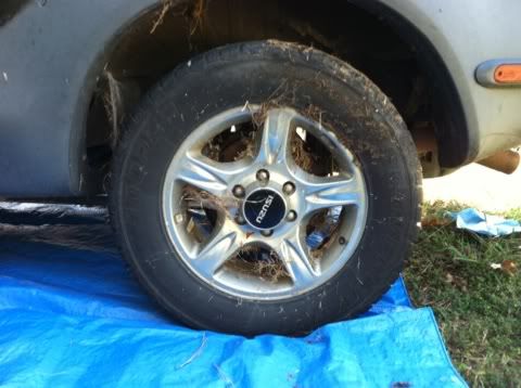

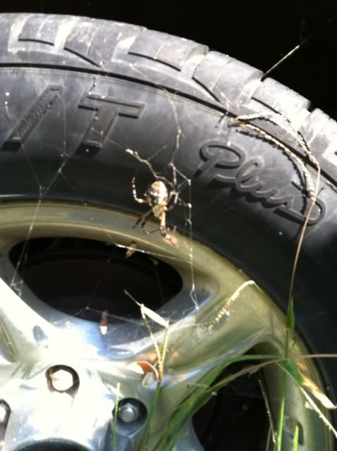

Check tires carefully, sitting uncovered it's possible the fabric has absorbed water and that can cause separation at highway speed. If you decide to drive on them take it easy and stop and check frequently. I would probably try to drive on them myself and see if they are ok. I've had several tires delaminate on me and aside from an adrenaline rush and some sweating on the side of the road I've never felt there was much danger. I've always been able to sort of feel it coming.
