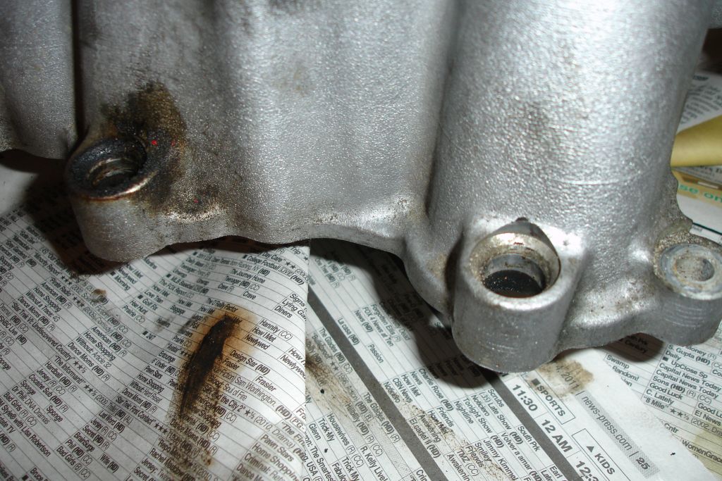

In my quest to fix my rough engine with rotten low speed driveability I took note of the buildup around the injector at cylinder 3. Notice the flare of brown oily buildup coming from the port:

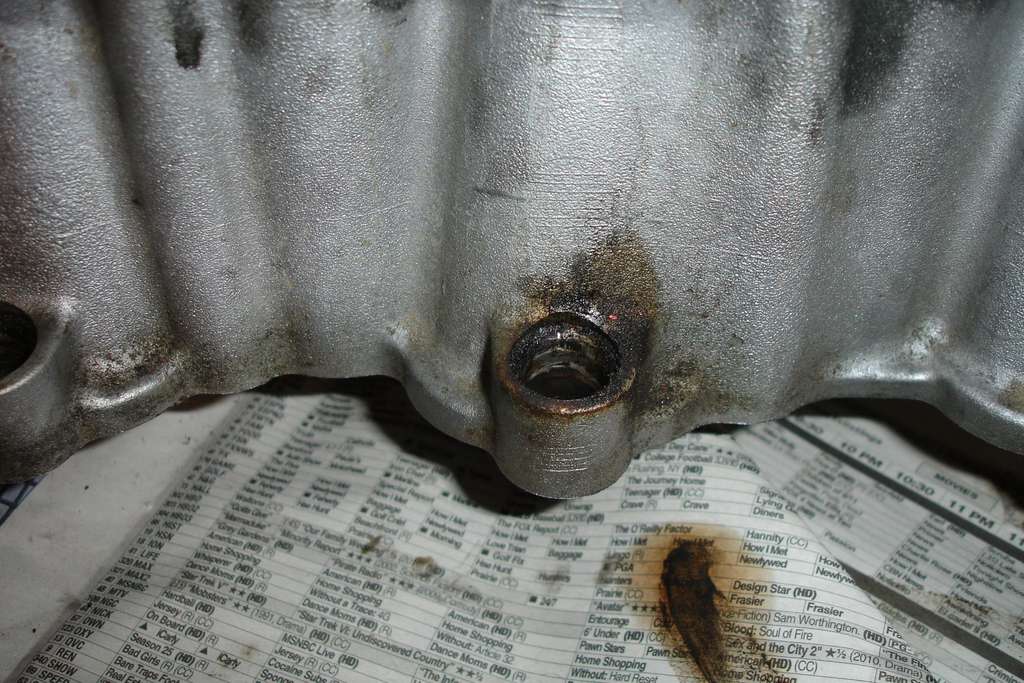

as opposed to cylinder port number one:

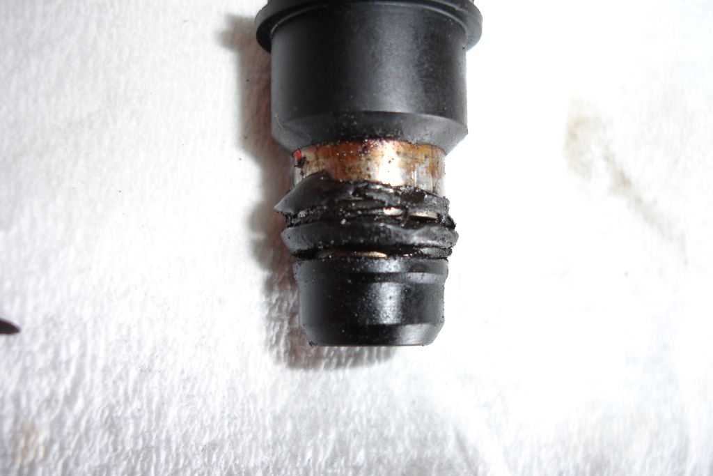

now look at the injector O ring: More than 1 injector had messed up O rings:
It no doubt was sucking air while the engine was on and blowing hot vapors out - which I noticed- while the engine was cooling.
