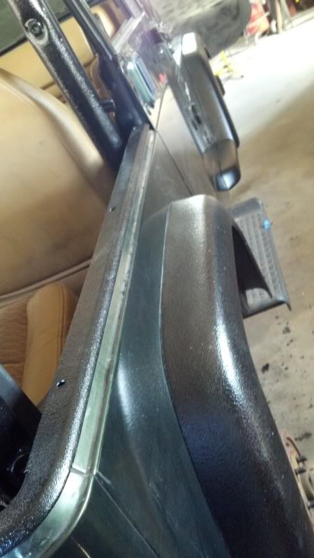

    SO, My GF got me a gallon of Monstaliner for my birthday, and we finally got around to putting it on this weekend. Lot of work, But I think it was absolutely worth it. The car looks great!
    Before:
    And After:
    The product goes on exactly as described, make sure you get the instructions for applying to plastic, though. The Bulldog adhesion promoter was a bit of a pain to find, but ultimately came out to about $30 for two cans, we needed just over 1 can to do the job. The Sprayway cleaner they recommended was at Home Depot for about $3 per can. Ultimately, we used 3/4 of a gallon of the Monstaliner, but once you mix it, it is done in about 6-10 hours.
    The product is black, so it's a little different than the original color, but the tintable Monstaliner is about 2x the price. I think the black looks great!

    I haven't heard of or seen the Monsterliner stuff...house, can you take some closer up pics? It looks like it's less textured that Line-X and Rhinoliner, but I can't tell.

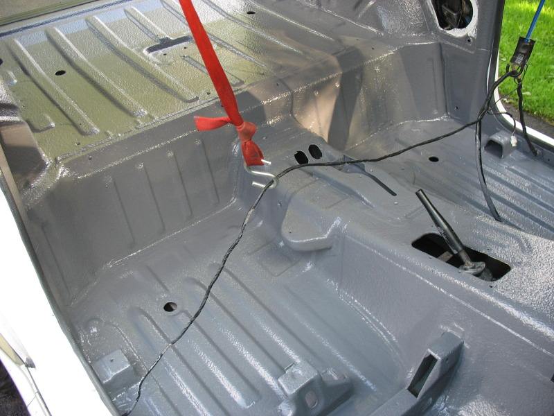

    Check post #3 for the link to the Jeep page containing pics, info, etc. Over 1/4 million page views and tons of people using it. Yes, it is textured. Some images I borrowed from the Jeep folks....

    Thanks for posting the pics eternal, that's a really cool texture. I def like it better than the rougher ones like Line-X. Hope yours works out great too.
