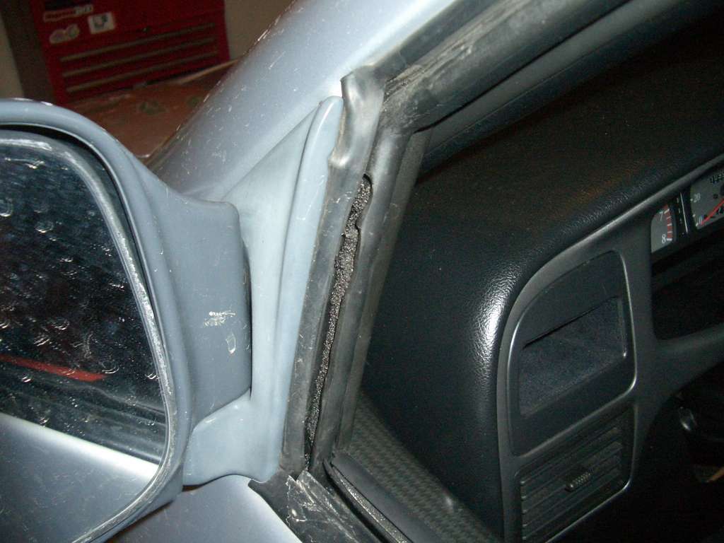

yes, I actually purchased the metal brackets but my platic pieces are not broken, that is not the problem
The other problem people noted was the rubber guides needed lubrication, that also didnt solve the problem.
I didn't see you mention it, but many have also widened the metal rail/track the leading edge of the glass runs in, to reduce friction/ pressure on the glass. I used pliers and opened up the C-shape metal track until it was wider at the edges, particularly near the top as that's where I could see it was binding.
I also had the SBC brackets installed even though my plastic clips weren't broken. I use pure silicon spray to lubricate the rubber channels.
Here's a fix using a bungee cord (Joshi & SlowPro48 have successfully done this):
http://www.vehicross.info/forums/sho...63&postcount=9
I recall there was one owner (Bulldoggie, and then tysamigo) that neither of the above helped. He tried putting some metal washers in a stack, maybe 1/2" or so, to act as spacers and push the bottom of the glass outward, and of course that made the upper part of the glass tilt inward more. I believe that solved the tilting and jumping the track issue. I recall he just kept adding washers (thickness) until the angle was optimized.
http://www.vehicross.info/forums/sho...8&postcount=38
