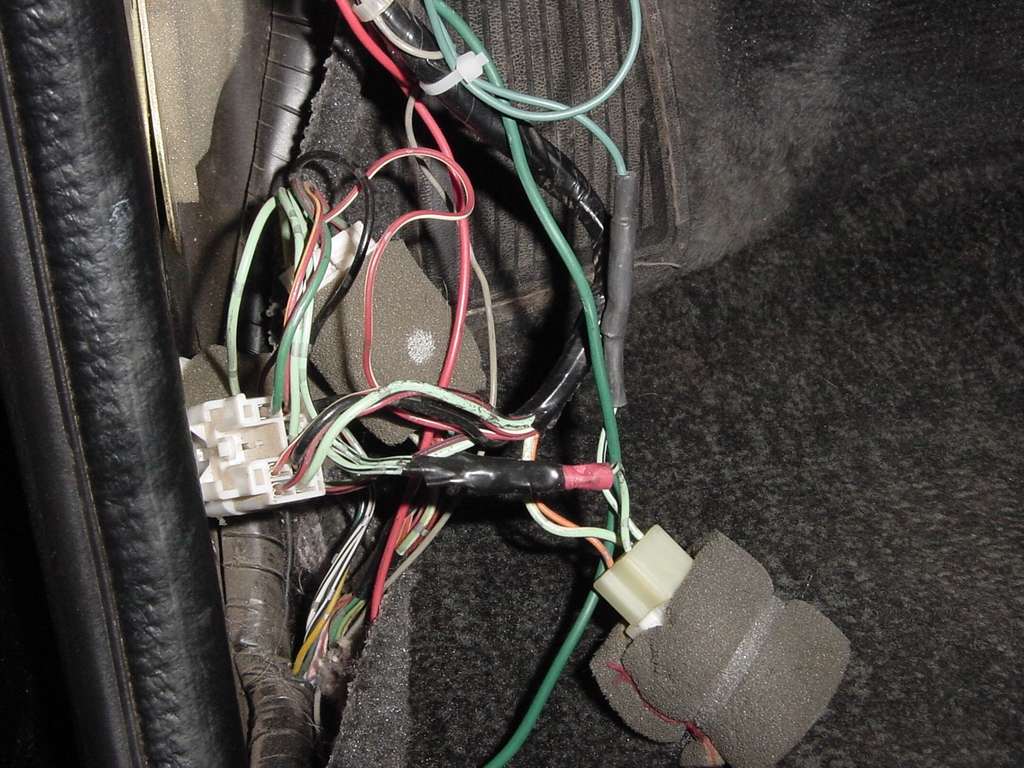

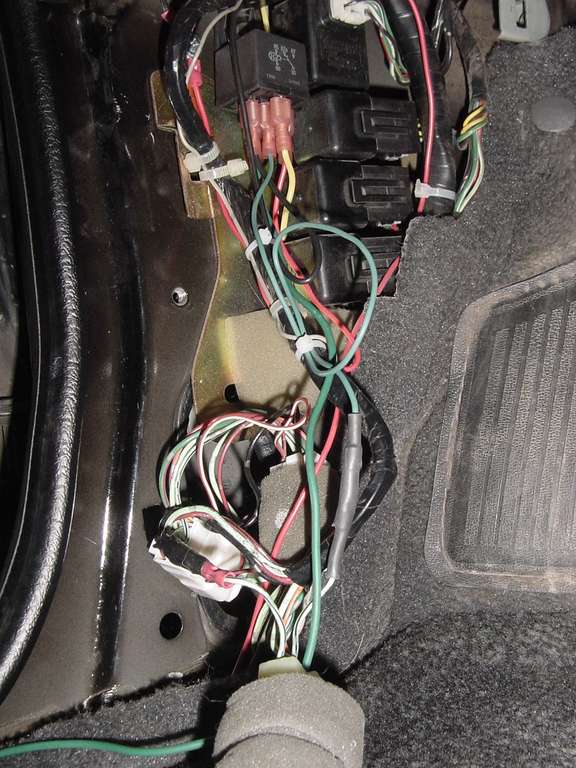

Earl, originally I had the wire for the open indicator light hooked up to the pin switch that turns the interior lights on when the back door is open, but it somehow cancelled out the button.  When the open indicator light was on the switch wouldn't work, so if I had my drivers door open (the dome light would come on) the button wouldn't trigger the popper. I just disconnected it from the pin switch at the back door and now it works just fine.  I think if I put a second pin switch back there I could use the open indicator light.
Anyway, the open indicator light does come on now when I press the button, but goes off when I release the button.  Sounds like you have the on indicator pin in the back of the switch connected to something that comes on when the headlights are on.  Did you wire it into one of the other switches in the dash?
