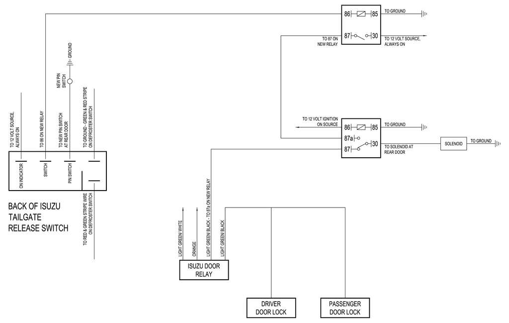

Sorry for the delay, but I finally got the new wiring diagram drawn up. I hope it's clear enough, but if you have any questions let me know.
I've lived with it this way for a few weeks now, and it's pretty cool to be able to walk up to the VX, push the disarm button on the remote a couple of times and have to door pop open for you.

I would assume this is what the diagram entails?

Knigh7s, that is what the diagram entails:
Key out; rear popper works by either pressing the unlock button on the stock Isuzu remote twice, or pressing the unlock button on either door.
Key in (and on); rear popper works by pressing the tailgate release button

One question...where is the best place to tie into the light green/black wire from the door relay (for the connection to 87a on the new relay) ?
ojmagg, everything that you need to access is right in the drivers side kick panel. The connections for the door lock relay, as well as all of the wiring for the locks themselves are all right there and I cut into the light green/black wire right near the relay. I would be happy to take a picture of my wiring if it would help you out.
