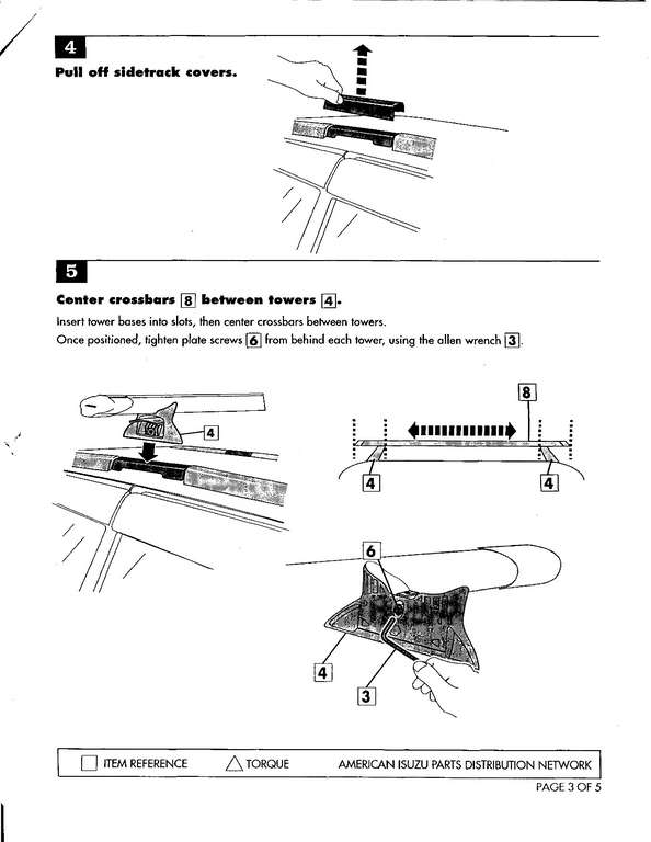

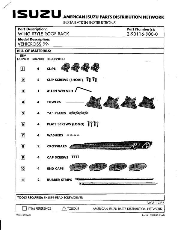

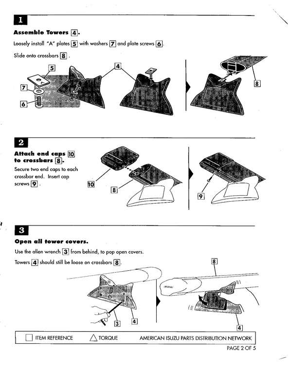

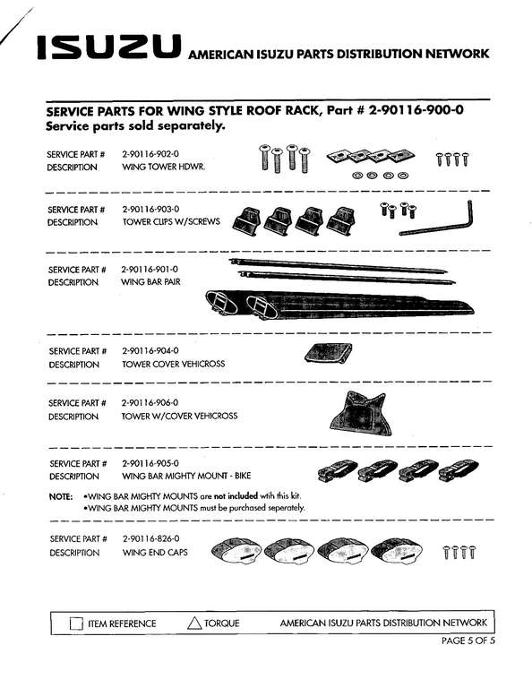

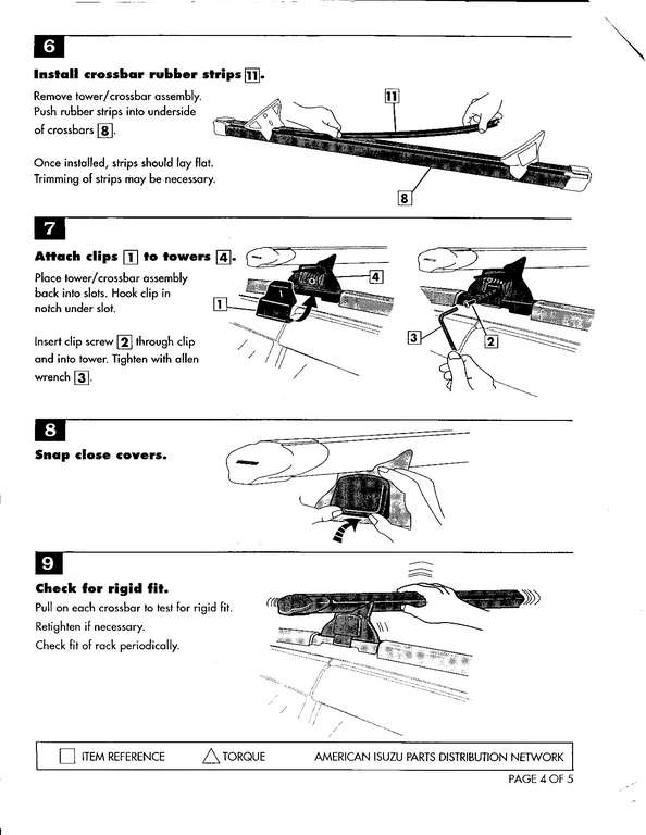

Do you guys think that the roof rack mounts would be strong enough to hold that kind of weight, or would it need some kind of reinforcement (exoskeleton)?
