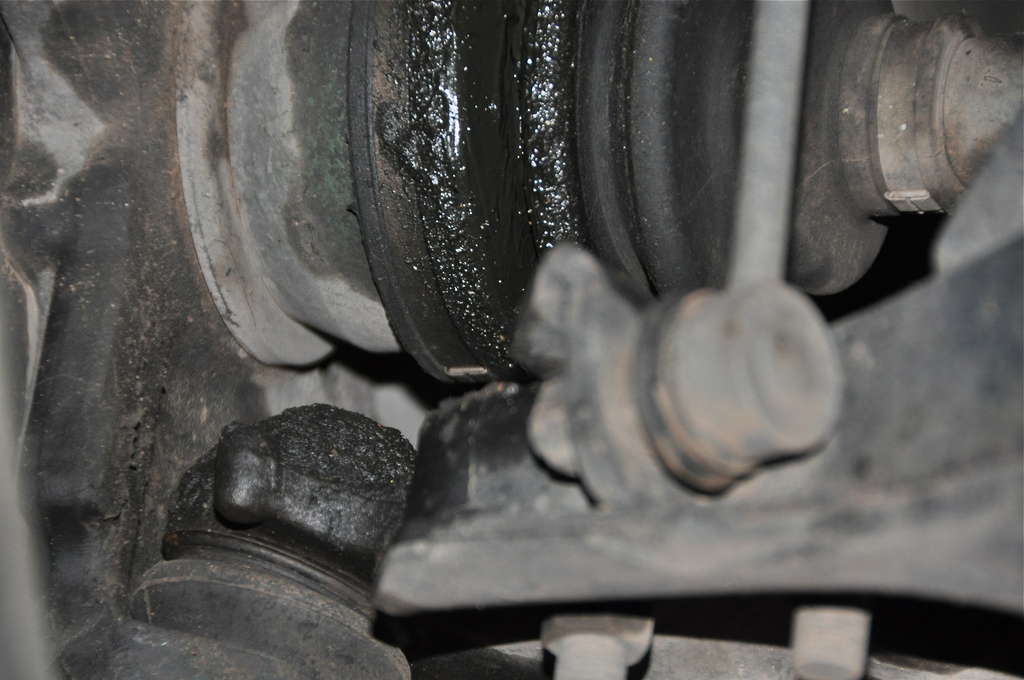

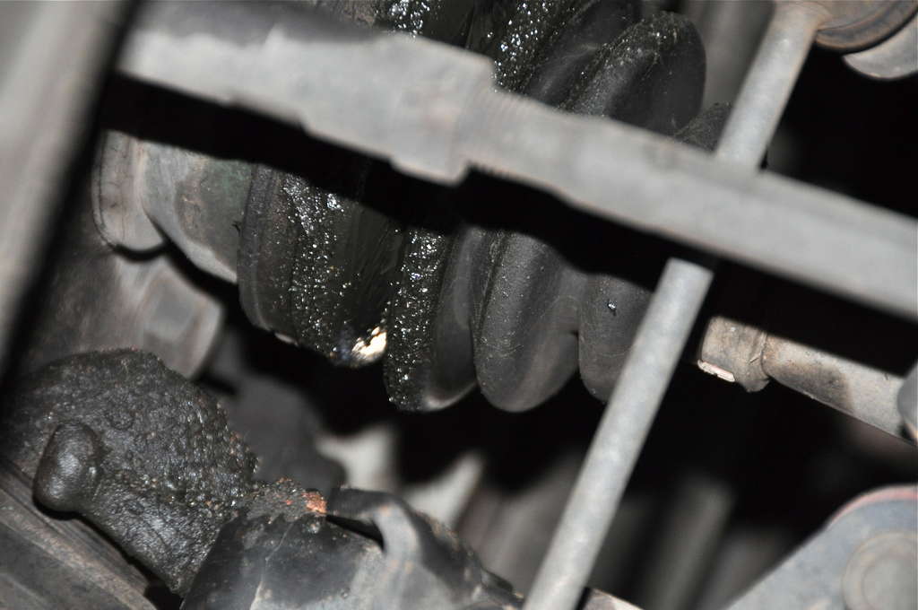

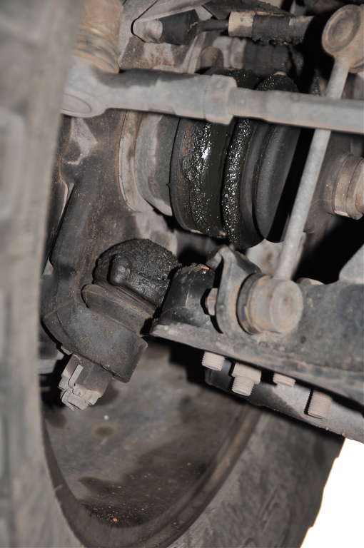

Mechanic discovered a torn passenger side CV boot yesterday while installing the Rocky Road SuperSliders. Didn't have any odd noises or anything.
Check out that large lump of grease below it.
Left it there for him to fix, didn't want to drive with the torn boot.
Any estimate how long it's been this way?
Maybe I tore it in Moab? If so, I've driven it for about 550 miles since.

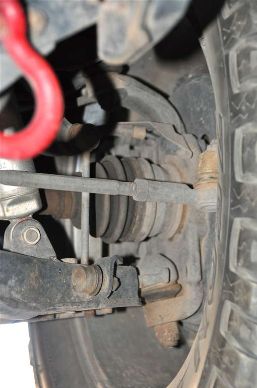

Driver's side- looks OK.
