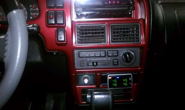

    After doing the chalk test weekly over a month period, I settled on 46 psi. They performed flawlessly during the (few) snow falls that we had this winter. I monitor my pressure and temperature on with my Orange brand tps I mounted in an extra, altered, ashtray.

    I'd try a "happy medium" of 45-48 psi & go from there.
