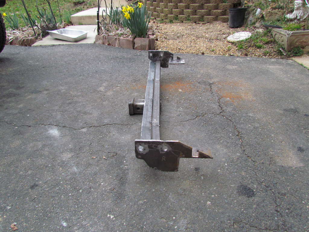

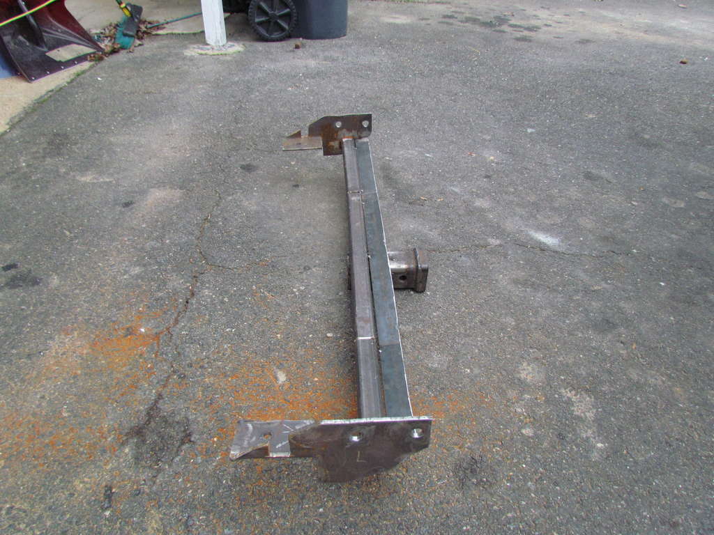

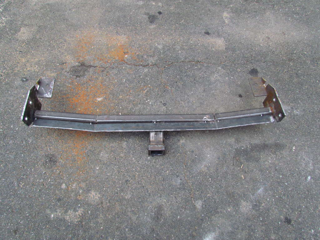

    As promised, here are a few pix of the hitch before it goes back to Welder Guy tomorrow.
