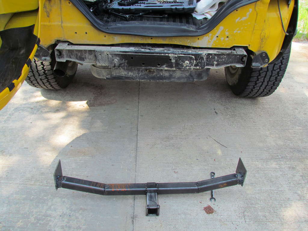

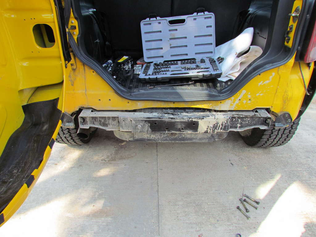

    OK, spent another 2 hours with Welder Guy last night. He's going to have to start over from scratch. We got the hitch tucked in as far as humanly possible (snug against fuel tank shield & frame crossmember). Still couldn't get the cladding to align properly.
    Our fall back position is to change from 2" stock tubing with 1/4" wall thickness to 1 1/2" stock tubing with 1/4" wall thickness. This should NOT significantly decrease the strength since we are WAY overdesigning anyway. The main reason that we were trying not to go away from the 2" tubing is that is what he had on hand. He'll be picking up the new tubing and tack a new copy together ASAP. Poor guy had such confidence in the last design that he actually cut enough tubing for 3 hitches. His plasma cutter is FUBAR & his welder is acting up so that's slowing him down too.

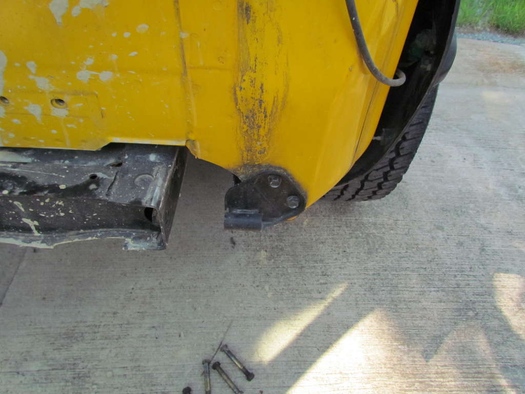

    Wierd: I've sheered off two of the 10mm bolts on the rear of the cladding. Not sure what that's all about. I've learnt to get the cladding off in 10 min flat. WooHoo!!!

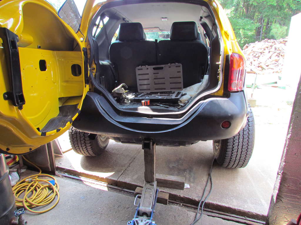

    Well, I stopped by Welder Guy's shop yesterday for a fit check with the 1.5 inch tube design & here's what happened:
    Arrived at 1430 & shut off VX.
    Went in shop to move stuff around so we could pull in the VX.
    Tried to start the VX at about 1440 ... no juice from the Optima Yellow Top.
    Hooked up a battery charger & left it for about 30 minutes.
    Still no juice (even with the charger set to jump setting).
    Made run to AutoZone for new battery - Optima was only putting out 2 Amps.
    Got the new battery in at about 1615 (added Lucas to power steering res since it was below min).
    VX started right up but too late to start removing rear cladding. Brought the hitch pieces home with me to fit check & mark up for final assembly.

    I fit checked the latest parts from Welder Guy on the hitch. It looks like it'll work. Now I just hafta get the parts back to him for finall assembly. He wants to add a gussett for strength since we went to 1/5" thick wall tubing. I'll keep you posted.
