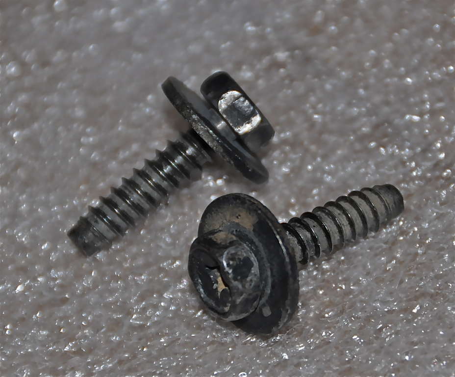

    When I test fit my JDM mudflaps, found some of the existing flange bolts in the rear wheel well of cladding were just a tad too short to catch with the mud flap in place. They're 25mm long and some weird thread pitch. We figured 30mm would work.
    Took it to Fastenal, they id'd them in a book, but don't carry them. Gave me part # and name of an auto paint shop that carried them.
    Went to auto paint shop, they ordered them.....or so I thought. Two weeks later I call to check, they determine never ordered. By this time I can't locate the paper with the part#......have to go back to Fastenal (it's closer) and start again....
    They're M6 x25mm, and I "think" Fastenal said pitch was 1.81. Anybody know?
    I plunked around on the Isuzu schematics info but couldn't find that detail.
    Here's the bolts:

    I have indeed, and HomeDepot....neither had anything close, so next stop was Fastenal...was surprised they didn't have anything either. Fastenal sales person looked them up in a reference book (I can't recall the mfg name), noted they had a very course thread, and gave me the part # from that catalog. Looks like I'm goin' have to revisit them and get the part # again. (No, I'm not putting them on before Moab....in addition to the 2 cladding screws, they ALSO require several long strips of double stick tape to complete the installation....so they're not a quick removal once installed. I got the waterproof 3M doublestick tape, so I'm all ready to go once I get the longer flange bolts)

    I'd forgotten about that thread, nice! But these are flange bolts, they're the two at the bottom and rear of each wheel well arch. Looks like those have a very course thread too, like the ones I'm after, but I'd need a bigger head ...(ok, no comments boys!) I recall the Fastenal person saying he could tell these were definitely automotive bolts because of the very course thread.
    I'm going to stop by Fastenal with your part #and see if it leads us to an alternative. Thanks.

    Pic of the bolts I'm after in 30mm length.
    KAT,
    You don't need to match those screws 'zakly. As long as it's a slightly larger screw, it'll self thread the hole during install. I think that those are the same ones that I replaced with pan heads in case my tires contacted them during tight turns. I picked them up at Lowes.
    AFAIK, Ace buys all of their fasteners from Fastenal (at least the one local to me does) so if Fastenal doesn't carry a specific screw, then Ace prolly doesn't either.
