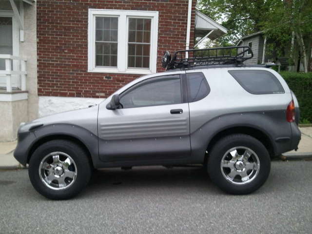

I just finished making a light rack that easily bolts to my LoadWarrior. I was thinking its actually pretty easy now that the measurements and such are figured out, and fairly inexpensive.
my total cost was
$8 in steel
$5 in misc bolts washers and nuts
$15 for clips made for the loadwarrior
I mentioned to tom about his welderguy might want to consider making them since they are so inexpensive, so I wanted to gauge interest here..

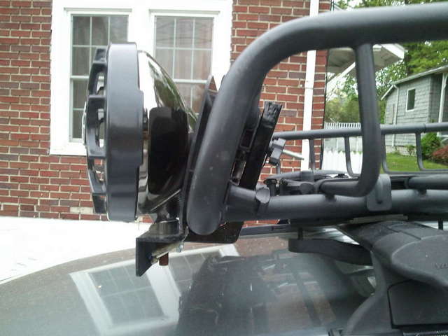

here is how it works..
right angle steel (or aluminum) with the lights mounted on it.
two angled L shaped brackets of square tube steel
4 yakima snaparounds (i got a set meant for mounting a powderhound to round bars)
the L shaped brackets get secured behind the fairing using one snaparound on the top bar and one on the bottom bar
the bottom of the L bracket sticks out about 2-3" past the bottom of the fairing
The right angle piece with the lights on it rests on top of the brackets and secured with two bolts to keep it from sliding/bouncing around
and the end result...
