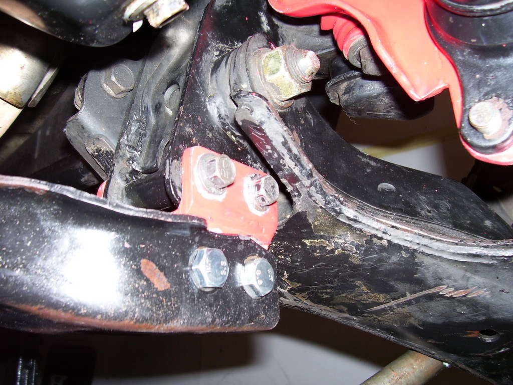

    After installing this new lower profile front bumpstop and doing the ball joint flip I added an inch or two of downtravel and now the a-arms touch the mounting bolts on the front cross member about the same time as the low profile bumpstops. I am looking at getting some more narrow bolts for the front cross member once I install the modified cross member I just got in the mail from Joe so that those bolts no longer limit down travel. Then I just need the ball joint spacer from independent 4x and the torsion bar suspension travel upgrade and the VX will be maxed out for front wheel.

    Here is the a-arm contacting the bolts on the cross member (after ball joint flip and lower profile bumpstops installed):
    In this photo you can see the a-arm upper bumpstops that Kat mentioned that limit up travel and soften bottoming out in the front, also note that the a-arms are not close to contacting cross member bolts, this is before ball joint flip and lower profile bumstops:
    In this photo the low profile front bumpstop has been installed and you can see the plate it contacts with on down travel just below it, but I have not done the ball joint flip in this photo yet:
    Ball joint flip done:
    Before and after of suspension down travel with ball joint flip and lower profile bumpstops on front. Hard to tell from the angle of the photos but I gained between 1-2", it was a very noticeable difference especially when looking at the a-arm to cross member bolt change:
