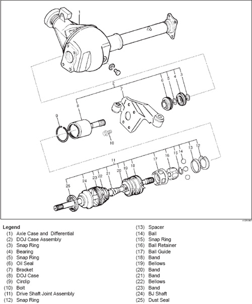

Next to #1 on the diagram, there is a square weight bolted to the top of the axle. I started having a knocking noise after dropping the diff 2 inches and found it was the weight against the frame. Anyone know the purpose & what will happen if I remove it?
