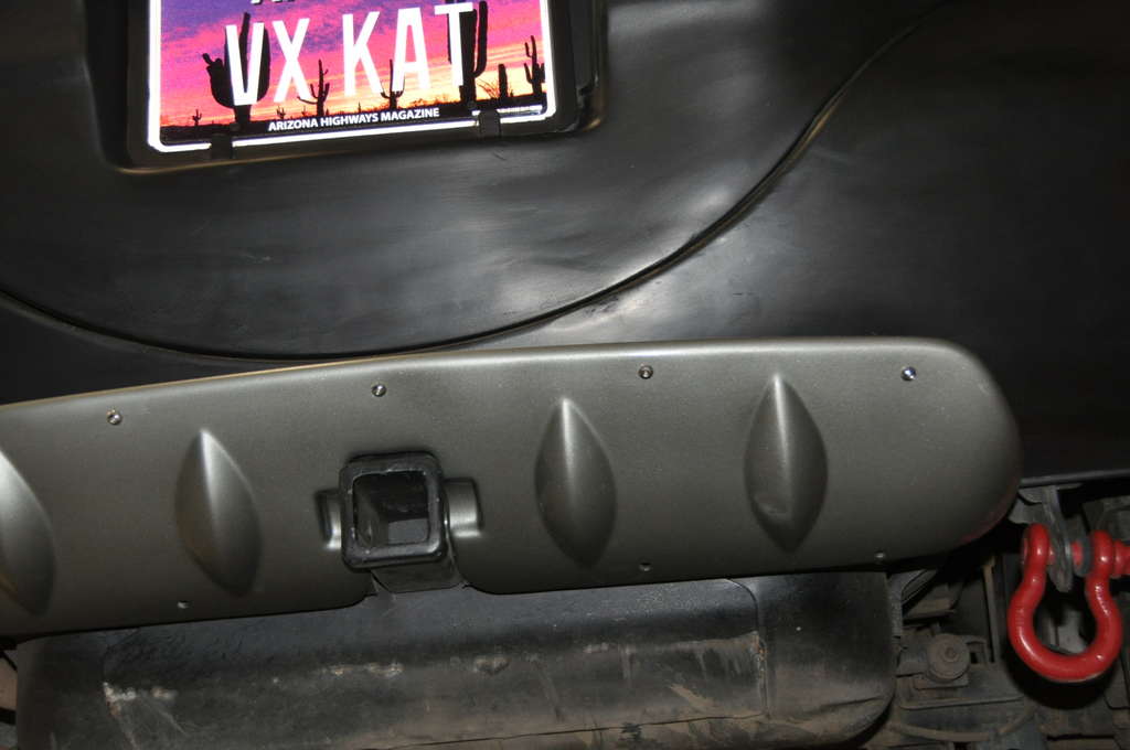

Anyone have a Curt hitch and one of Ron's rear skid plate on their VX. Trying to figure out if it needs to be notched to fit and how much to take off.

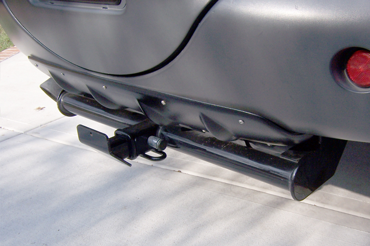

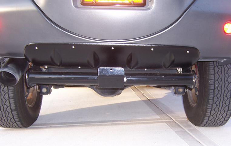

I found some pics a while ago, think the first is johnnyapollo's, and other is Navistar's.

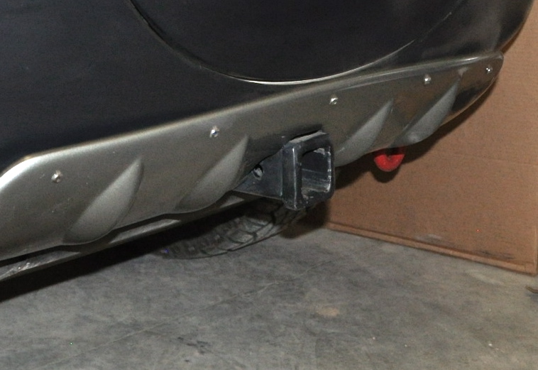

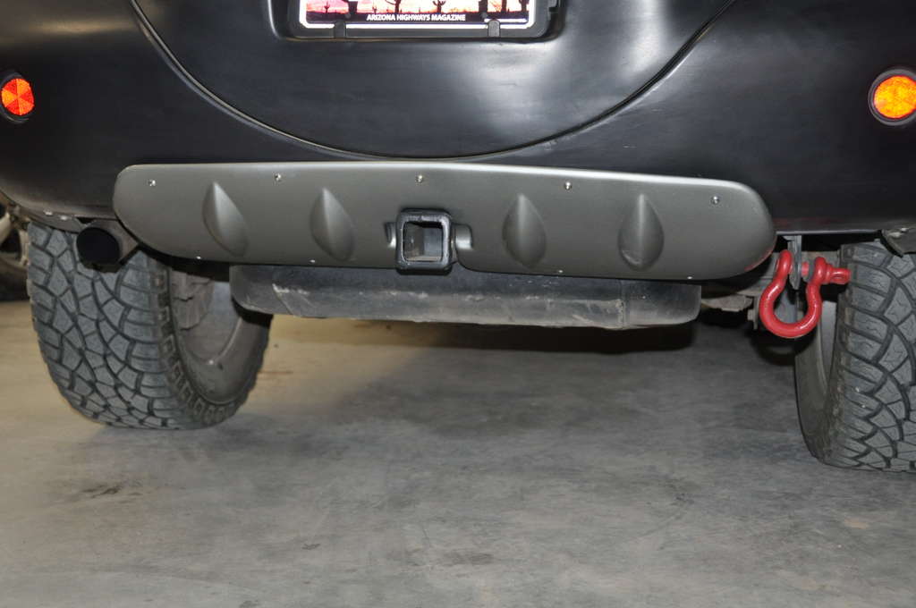

Is this what yours will look like, or more like mine in the last 2 pics and 2 thumbnails?
If the two pictures right above your vehicle are navistars I think that is a Curt like mine.
I am going to try and e mail navistar.
In your big pictures it looks like you couldn't open the back door without hitting the skid plate. Did you then refit? Did you just need to make cut out bigger or did you need to cut down the piece that sort of wraps around under the cladding?
I think she took those pix before the skid was actually mounted (just resting on the hitch).
Yeah, sorry, I took those before I'd pushed it all the way down. It clears the door. I just uploaded some newer ones, with the skid in it's proper place, but still not mounted.
See why I didn't understand your PM last week about "the pin goes underneath, skid is on top"....I was talking Tone style hitch, you were thinking I had a Curt type hitch. Now it's all clear.
