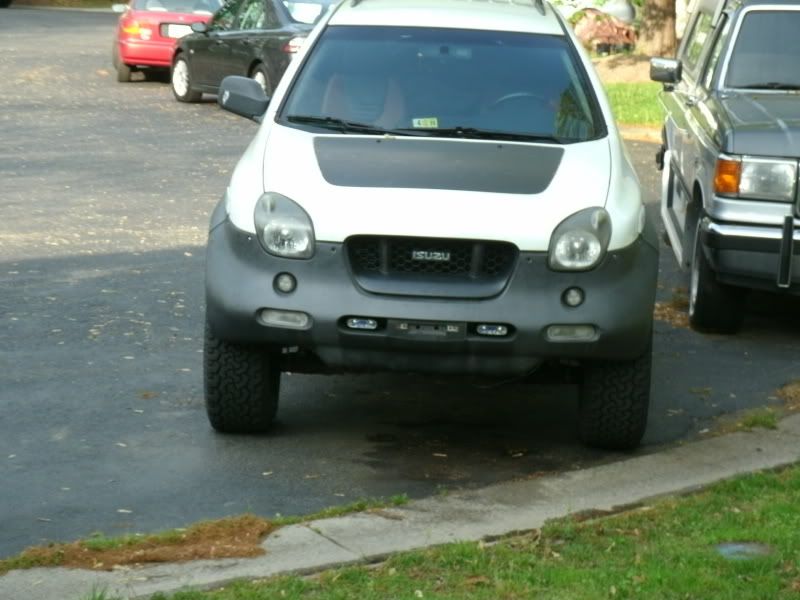

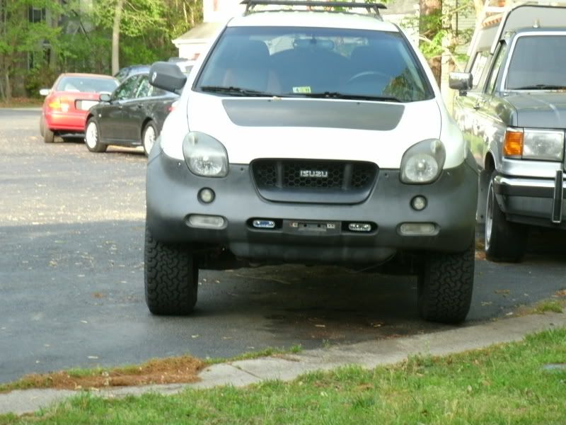

    here are some shots of front:
    Do you know how/ if the light pattern from the LEDs was different when it was behind the OEM lens cover vs. w/o it?
    Feb 2010
    1999 Ironman,#1-1767, #2-1326
    504
    I hooked up the LED's to the battery and shined on the house wwith just one and don't remember it being different, though it was just one and held in my hand so cann't say for sure.
