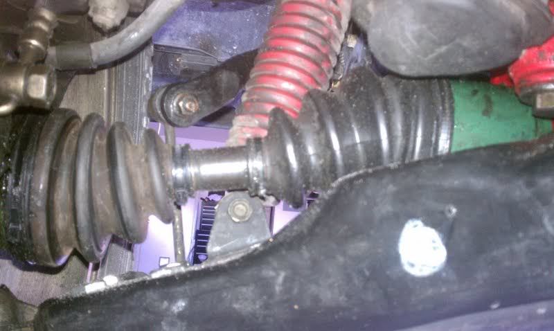

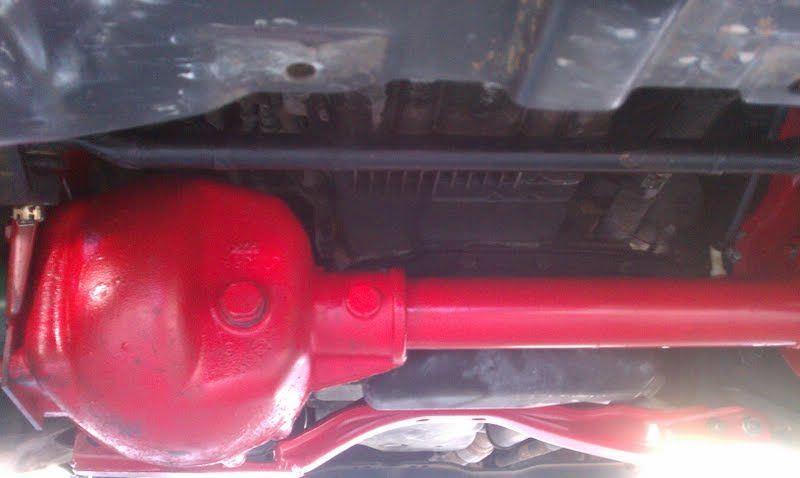

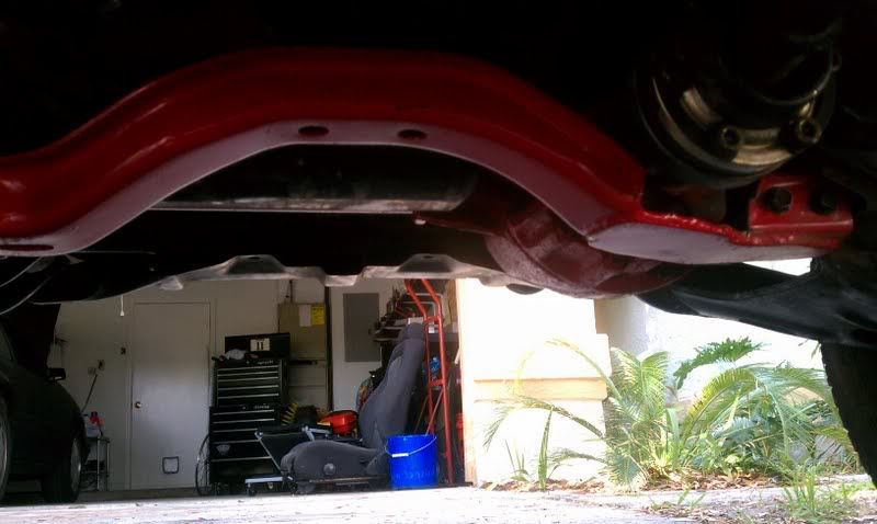

    Here is everything in place under the truck. I scratched the diff up a good bit when trying to get it back in place. I'll touch it up some day.
    And the new angle of my dangle!
