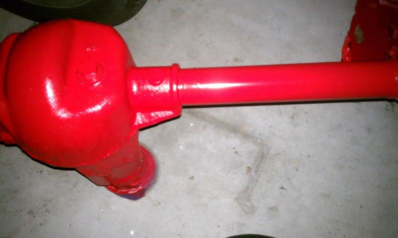

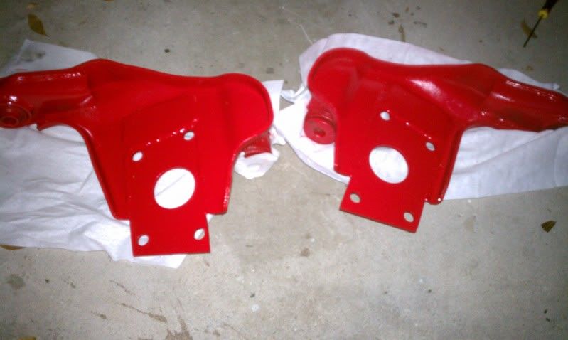

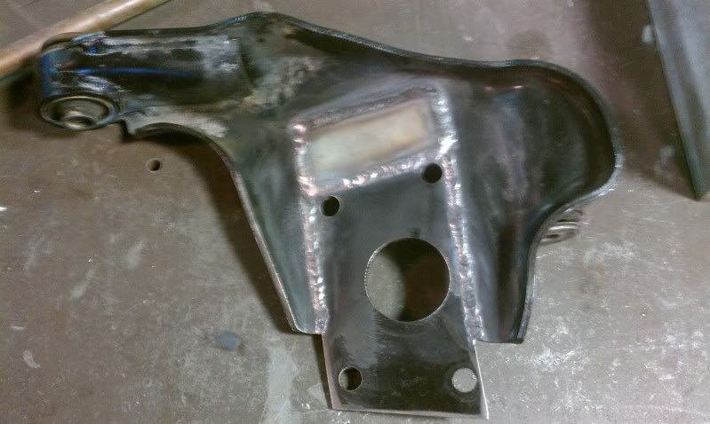

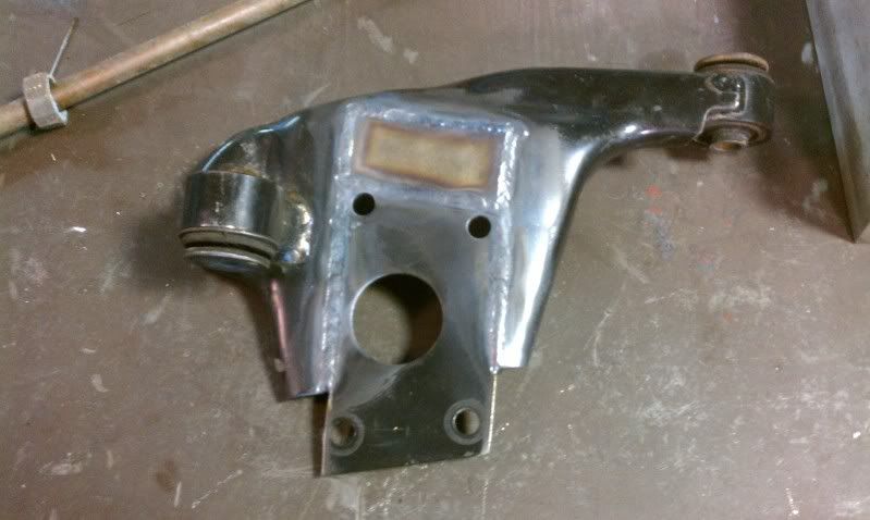

    I'm at work now and fixing to go finish the cross member. Here are some shots of what we did with the brackets, and the newly painted front axle.
    Painted them with some rustoleum Safety Red. I like it! It isn't quite so extreme under the truck. Looks really loud in these photos.
    I also painted the front axle housing and the cross memeber, which I'll share when I'm done with it tonight.

    And I agree with that about the bolts having wiggle room. I would think that if it were to privide much structural strength then there would be bushings or thicker metal at the mounting points. Either way it's going back on, brigt safety red and all! And if it were ment as a skid plate for the diff then it's gonna be better than factory, we used 1/4" 304 stainless for filling in material in the brackets and where I cut out the cross member we welded the same in place there. MUCH thicker than factory metal.
