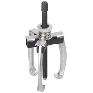

    To get the steering center link and/or tie rods loose you WILL need a puller. I would suggest a 3 arm puller like this one:
    http://www.amazon.com/OTC-OTC465-Thr.../dp/B002RCNKMO
    Only $40 at amazon and it will save you hours and hours of frustration/cursing/bruised knuckles and hammering with a 5lb hammer. Even once the puller is on the joints and torqued down almost as much as it will go, you will still need a few nice hits with the hammer, but the puller does its job and releases the joint very easily once you know what you are doing.

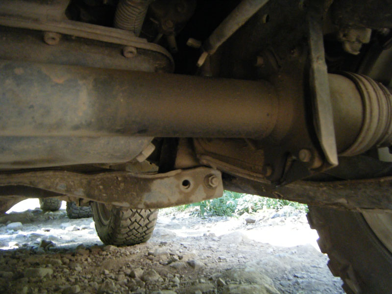

    That crossmember isn't a structural piece anyways so the only thing that would come from it not being in is possibly banging the front diff on something. Here is a modified crossmember to maintain max ground clearance, just notched out the factory crossmember. Some guys have even cut and welded that area around the diff a little lower instead of notching it but either works:
