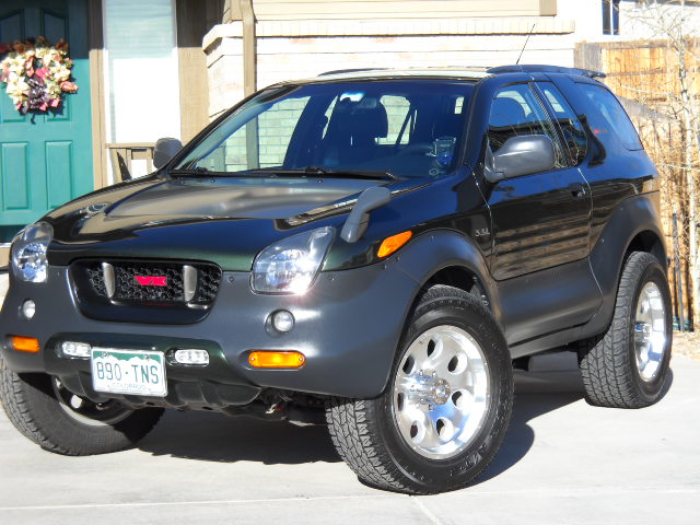

    Front plates in CO as well. I had to use the 50 with the Rowhard skids...found them at Home Depot here in their specialty fastener cabinet. I also have a clear plate cover that I really like that I had to add some length for.

    IIRC it was a pack of about 5...I bought the 45s and the 50s and ended up using the 45s on the bottom and the 50s on the top. The bottom was tough to get lined up and I used the 50s at first to get it started, tightened it all the way, put a set of vise grips on it, took it off and quickly changed to the 45s. Just too much extra on the end to leave the 50s on the bottom but couldn't get the 45s started...
