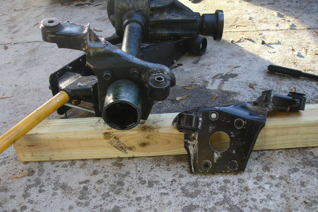

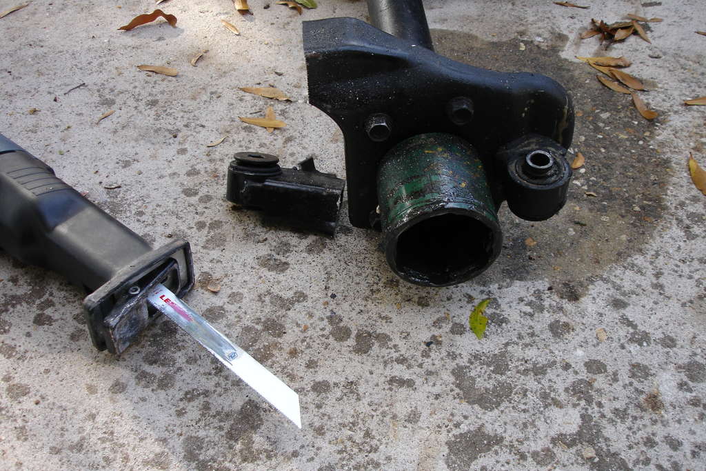

Almost afraid to look.... Removing the Differential is NOT fun but rewarding once you do it. I dropped the steering linkage by removing the 4 bolts from the passenger side bracket and then a pitman arm puller on the steering gear. By removing those 2 components the entire linkage fell out of the way.
