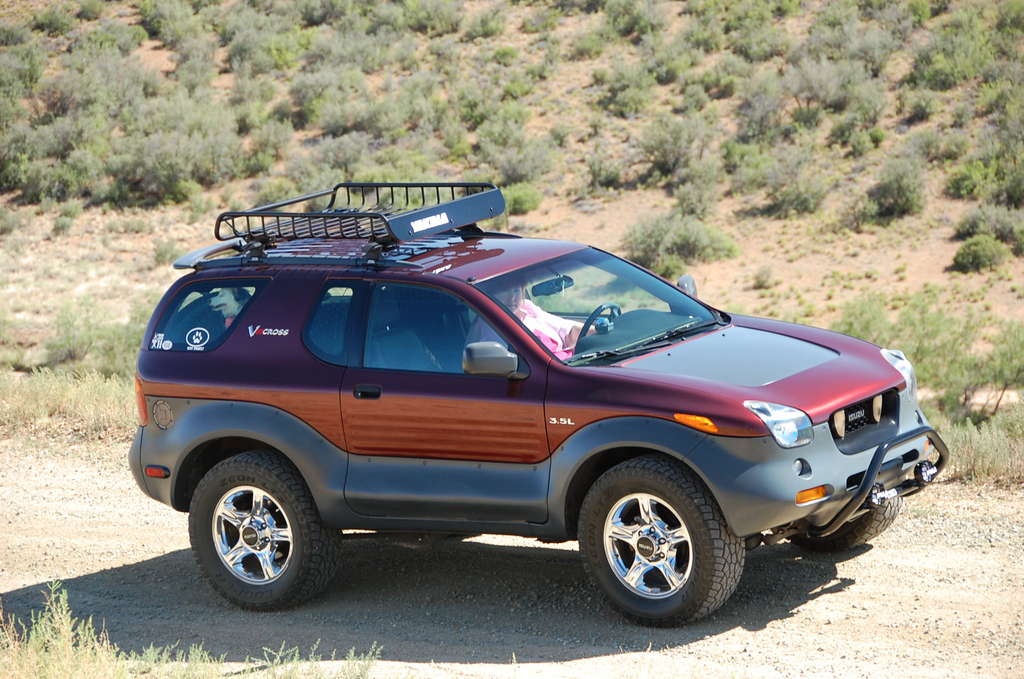

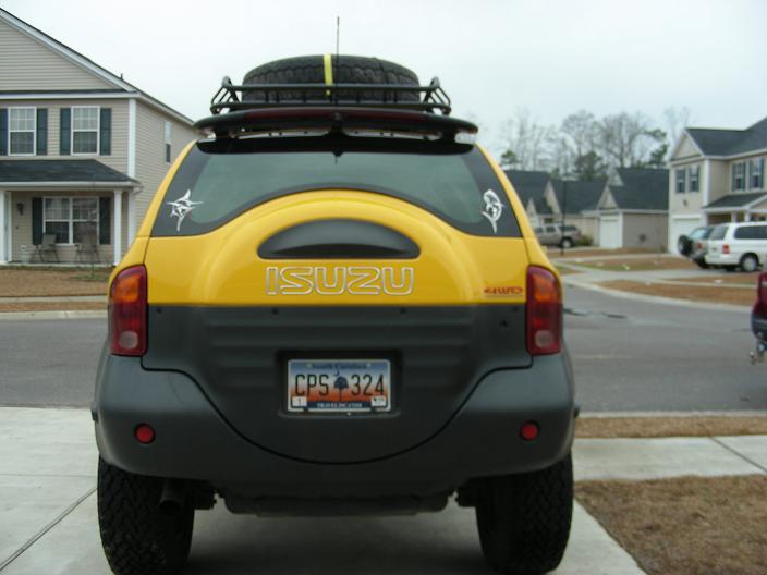

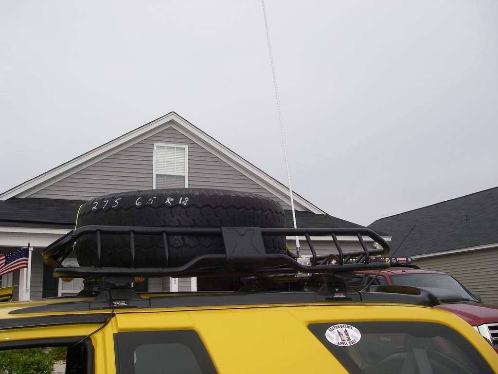

    Yakima says they don't have any basket that will work, don't worry, they do!! I have the Yakima LoadWarrior and it attached to my OEM cross members without any modifications. I carry my oversize spare in the basket, just like you want to do. Yakima makes a "spare tire attachment" bracket kit for around $70. I'd suggest you get that as it will work perfectly, and hold the rim/tire securely. I also have a ratchet strap on mine.
    The MegaWarrior basket will also fit our bars.
    Here's some pics to give you some idea what I'm talking about:
    Showing the 2 cross members.
    You can see the Yakima mounts perfectly curve to grab the oval cross members....um, disregard the Barbie Doll, that was part of a joke we did last year.
