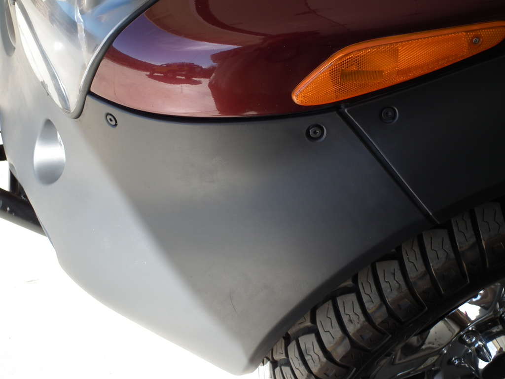

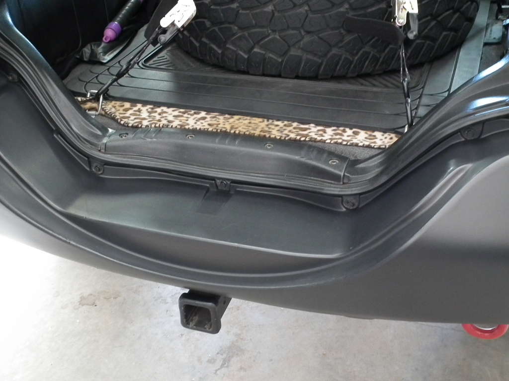

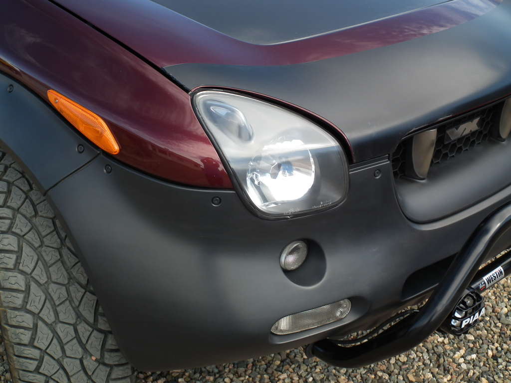

    Latest update:

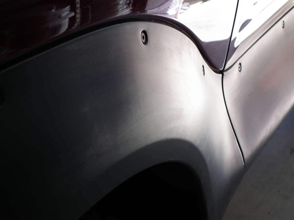

    Got a bunch of trail rash a few days ago, on both paint and cladding. (See pics at very bottom of post)
    Used Meguiar's medium cut compound on the paint, worked great.
    Scratches on cladding were pretty light, but still were physically scratched into cladding.

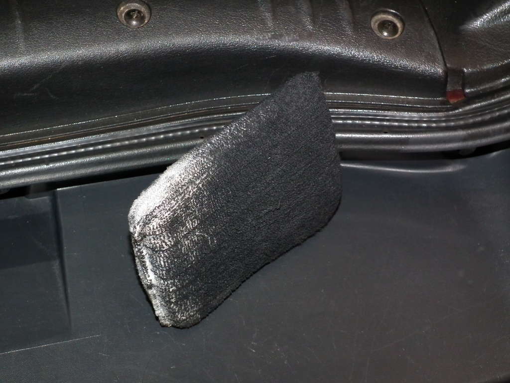

    After thinking on it for a few days....decided to use the applicator that came with the TC Black Fusion...a sponge covered in a terry cloth fabric.

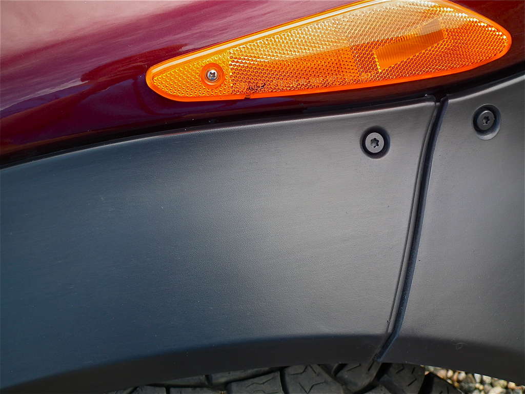

    Had a little dye mixture left, so dipped the sponge tip and top 1/2" or so.
    Pics make cladding appear a little lighter than it is...but it's still a dark charcoal.
    Applied in broad light strokes, WORKED PERFECTLY!!! Leaves no streaks or texture marks, and you can control how much is applied. I got rid of the streaks I did have using this. Plus, it used the product very sparingly...whereas I thought it would absorb and waste a lot of it.
    I'm now 100% sure I can touch up any scratches in the future. Nothing chipped off, it's totally absorbed into the plastic.
    Mfg has a topcoat product I'm going to look into for details. But if it's topical and can chip off I'll skip it.
    *** THIS IS ABSOLUTELY THE BEST APPLICATOR TO USE TO APPLY THIS DYE ***
    Can see scratches with the sunlight just right. But the dye just covered it pretty much, but since they're physically there, you can still see them in certain light.
    3rd coat significantly improved problem area I had on this corner.
    WAIT, whose paw prints are those? Cody!!!!
    Pics of trail rash while still dusty.

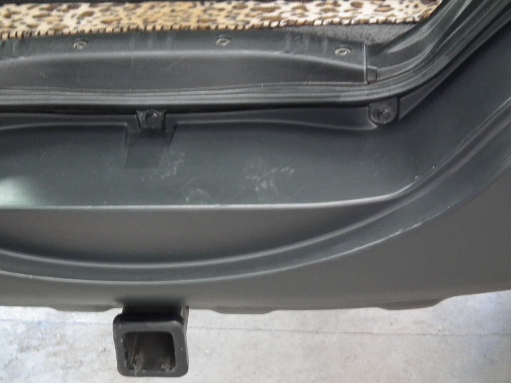

    FORGOT one other point... This stuff doesn't collect as much dust as my nekkid cladding! I can't explain it, but am wondering if it has something to do with static electricity. My nekkid cladding always had some when I'd wipe the dust off with a dry towel or car duster, but now it doesn't.
    You can see in my trail pics, after 3 hrs on a really dusty trail, eatin' dust from in front of me the entire time, there isn't as much dust clinging to it as in the past. There's a little more toward the rear, and there's plenty on the magnabra as you can see from where I wiped some areas.

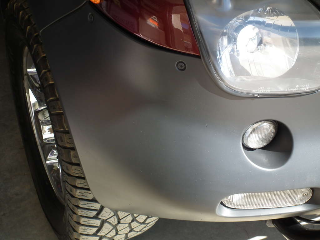

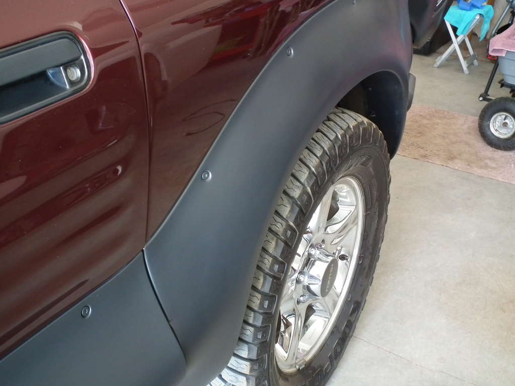

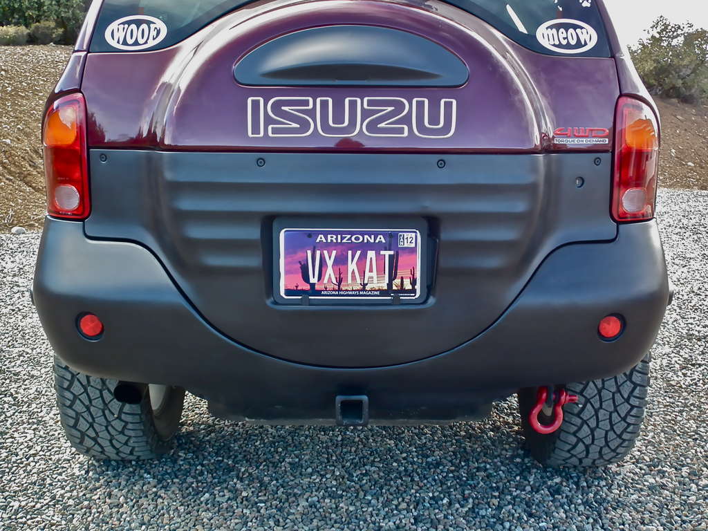

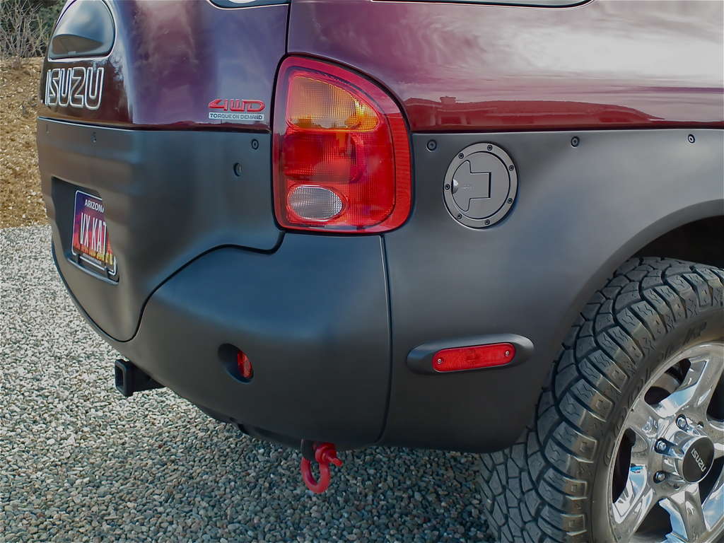

    Another update....
    I wanted it a little darker, so I mixed up another batch, using a little more black and have plenty left to do touch ups in the future..
    Color is just perfect for me, really nice dark charcoal.
    I'm absolutely happy with the color now!
    Plus it looks good with my matte finish grill.
    Those of you that want true BLACK cladding, using just the black will definitely get you there!
    Last pic shows you can still see original texture of cladding. Means this stuff is mostly going into the plastic, not coating it. And it's really a matte/flat finish, not shiny at all, despite pics making it appear like it has a little sheen.
