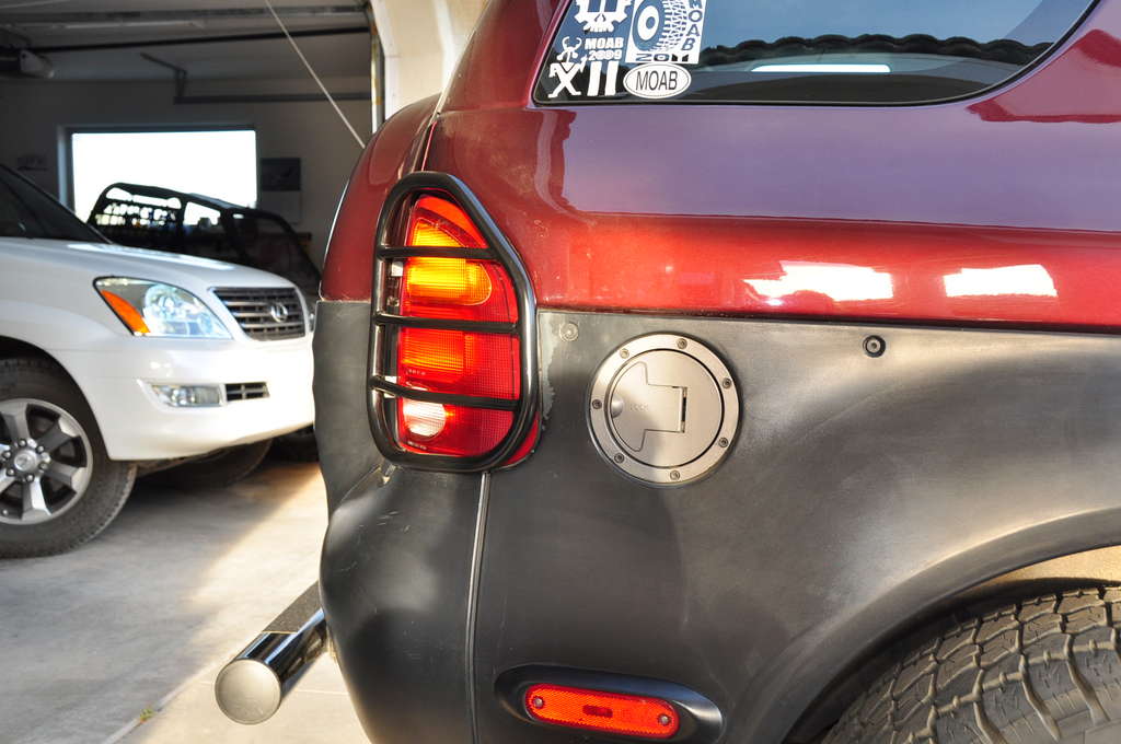

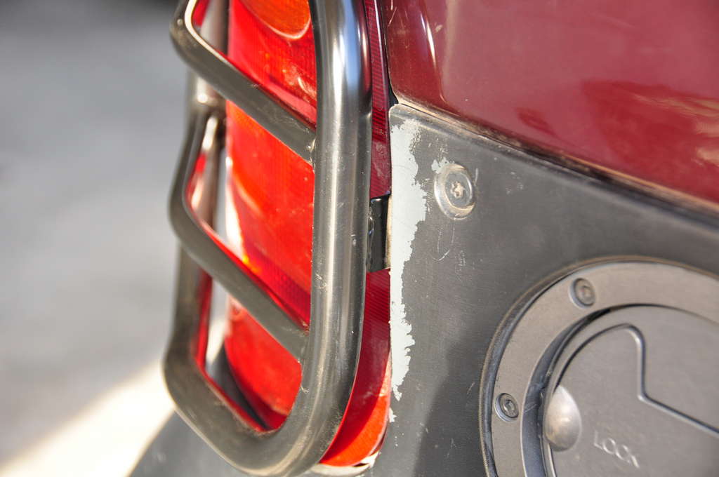

    Another option is Mar-Hyde bumper coating (dye) as sold by O'Reillys Auto Parts. I compared the ingredients to SEM vinyl/plastic dyes. They are basically identical. (And, btw, I also recommend the SEM products too. Duplicolor flat black or charcoal would be 3rd on my list.)
    Just like these roll-on products, you [only] have to thoroughly wash before application. In short, you need to remove road debris or wax to insure adhesion. I masked mine with blue painters tape and newspaper -- similar to the OP. I was able to do mine in one afternoon. (This is the 3rd time I've died my cladding. It's needs reapplication after 2-3 years....if you want it to look new. Each time, I only use 1 $10 can of spray dye. I think I used a bit more on my first application several years ago. I'm sure more coats would help with longevity.
    Here are pics of mine. I also recently added the skid plates after reconditioning a set AND reconditioning my hood insert. They were painted by Maaco in a metallic dark charcoal gloss.
    Does the Mar-Hyde product change the texture of the cladding?
    I've steered away from Gatorback for that reason.
    Feb 2010
    2001 VX 1320 -- Ebony
    728
    Thanked: 19
    No. It's a thinner coating than paint. The coating is thin enough you can't tell it's there. And, you can clearly still see the "sanded" texture of the cladding after application. Even after 3-4 coats over 5 years, you can't tell my cladding has a coating. I can still see the cladding's texture. It's thinner than paint because 3-4 coats of spray paint wouldn't retain the same level of detail.
