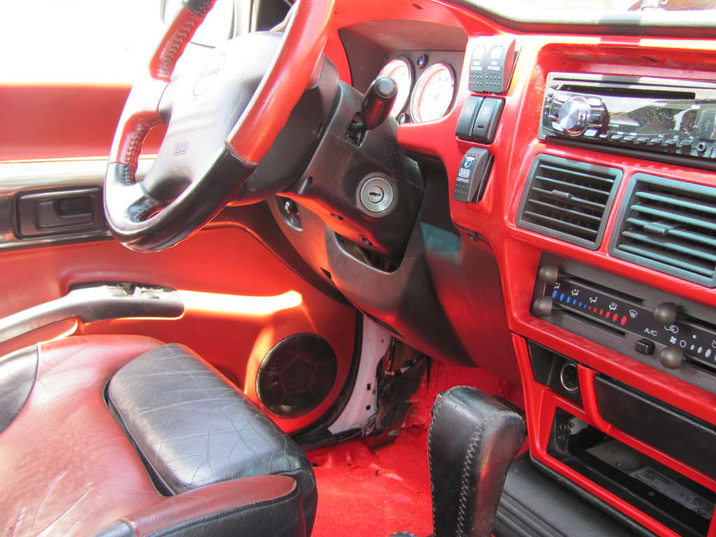

    Those rocker switches come with the purchase of the ARB lockers. One is for pump on, 2nd is for rear, 3rd is front (set to be activated in that order). They have a blue light to show when each is activated.

    Where did you get those switches from that are showing in the interior next to your steering wheel? I was thinking about doing something like that when I mod in a TOD-off switch.
    Here ya go: LINK
