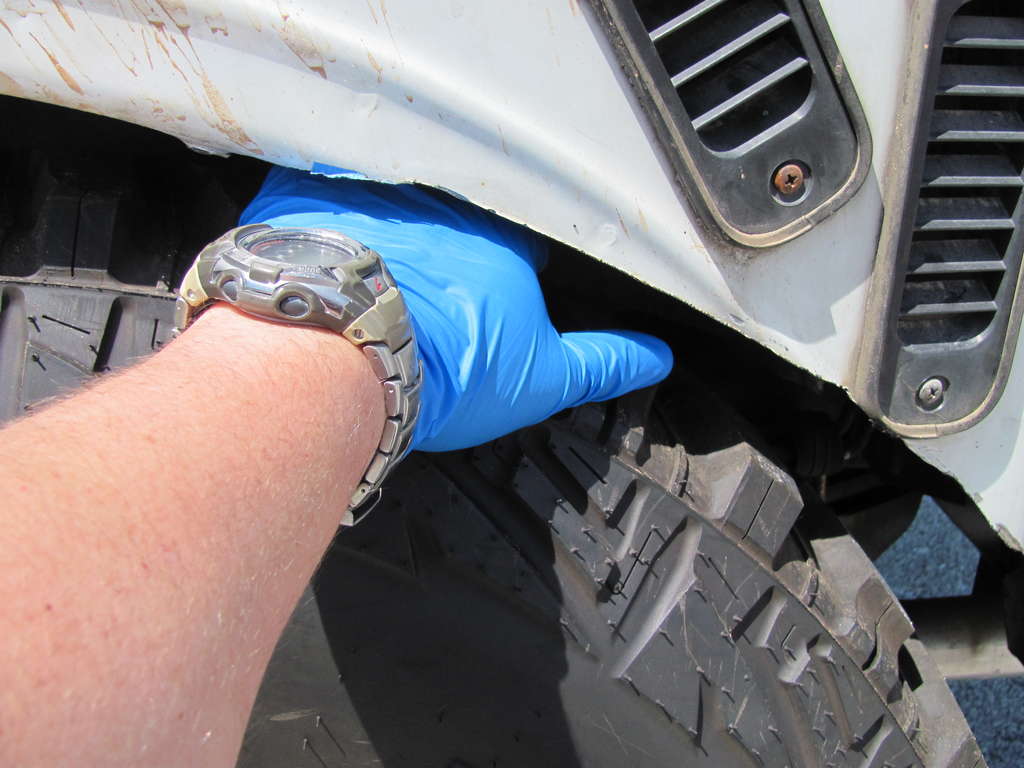

Pretty good amount of droop on this side.
Some tuck on this side
[img]
The amount of clearance with this amount of weight on it. This should do for now.
