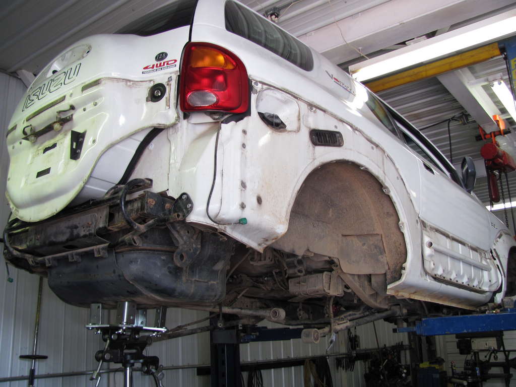

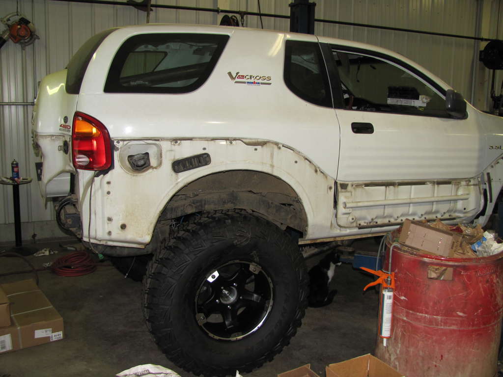

As some of you remember, my VX started off life with me after sitting at least a year in a small town in AR with a bad engine. Repair shop said about $7k for a reman engine, but then I would still be left with an engine with hard/expensive to replace parts. Couple that with the "limited" IFS and I opted for a driveline swap.
Here is where I began the planning (note the faded cladding):
Then I began my novice surgical removal of said driveline:

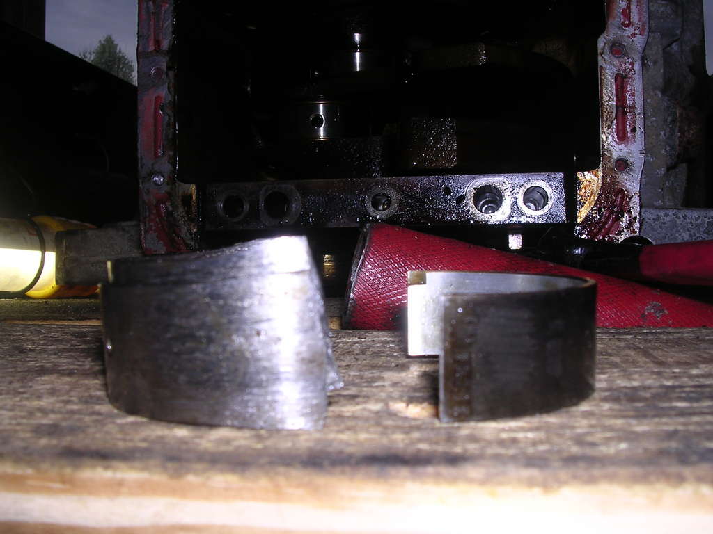

That is where I found the culprit to the horrible engine knock:
Triumphant at last!

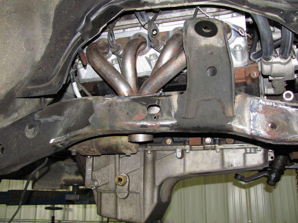

Sourced a 5.3L (327ci) Chevy Short Block with 60K miles on it:
And a Dana 300 transfer case:
And a Turbo 400 automatic transmission:

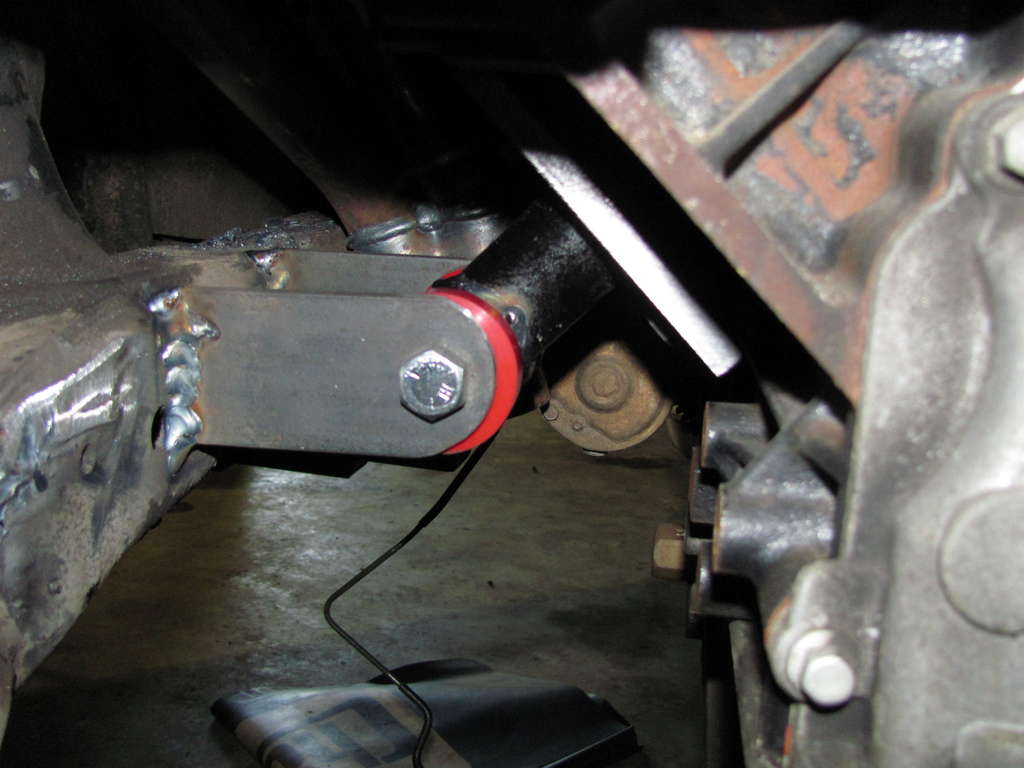

Like I was saying, nice goin, silent ninja! Regarding the steering... if you have room under compression, consider a high-steer setup to minimize bump steer and provide extra clearance.
