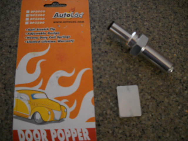

    Completed the install of the rear door popper with an Autoloc DP-3000. This is different that the one that Tone (RIP) included in his kit. I did not need the pin switch, since I already had one installed for the rear door alarm, and I just didn't like the look of it.

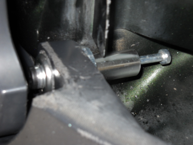

    Here is the "popper" that I used

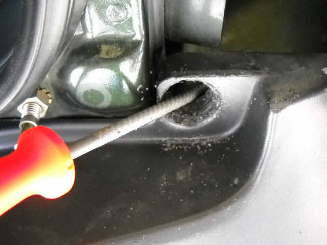

    I placed it in the rear cladding in an indentation that already exist for all. I was going to put it in the body panel next to this, but that area is a "black box" and there is no access to get behind that area. Glad I checked before I drilled a big hole in the body panel.

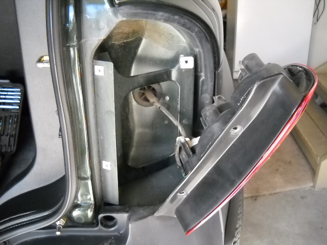

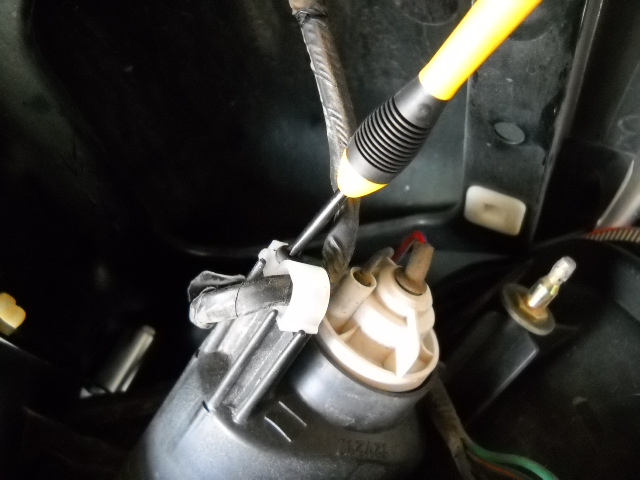

    Removed the tail light and the clip to make sure it was completely out of the way:

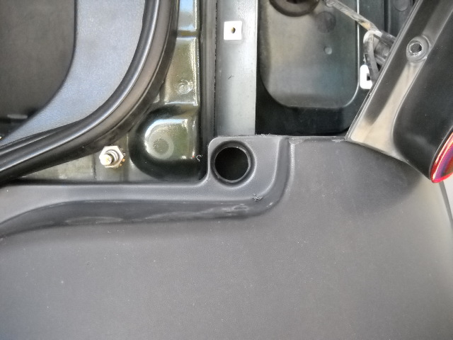

    Remove the plastic from the indentation. I used a 13/16" paddle bit that I had. You can see the body panel area that I was going to use in this photo next to the pin switch.
    The back edge of the DP-3000 and the opening are the same size. You'll need to rasp the edges of the opening to allow the popper to settle inside the opening a bit.

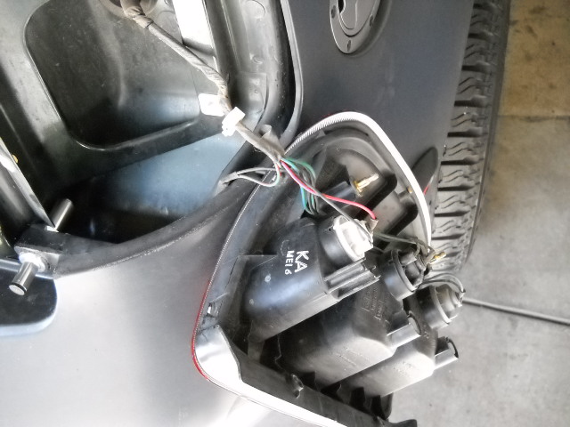

    The rest is just slide the popper in and secure from the back with the large nut. Perfect room for the extension that comes from the back when the door is closed.
    All finished
    Door closed
    Door Popped
