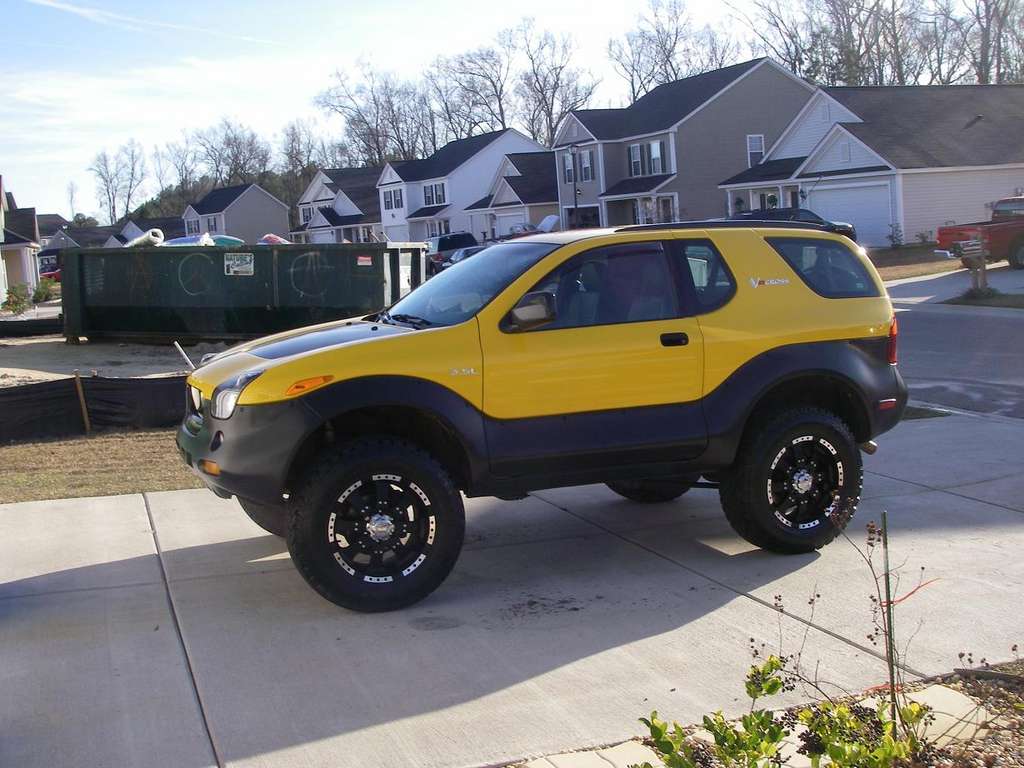

    Here is where I started, and since then, I have kept the same wheels as shown here, but went up to a 34"x11.5" tire. I also lowered the front end down to almost stock height, looks funny, but improved the offroad handling drastically. My VX just sits in the driveway most of the time, less than a tank a gas through it a month.
    Ultra Goliath wheels: 108mm bore
    6 on 5.5, 18x9, 5.5" back space, +12mm offset
    General Grabber AT2 275/65/18 P-metric
    OME919 springs
    14 turns on t-bar

    Marlin, you still look way above stock height. With a 31" wheel, mine is sitting WAY further up into the wheel well -- on the front. Mine is further up than your pic on the ramps!
    With 12mm offset and 2" more wheel, I gotta assume your tire is sitting more outboard that the two pics in this thread portray.

    Hold on, read the post, I am at stock height now, or very close to it anyway.
    The tires in the pics were only 32" x10.9". Those pics are from 2 years ago when I first lifted the truck and a bunch of other hoohah..
    As for the offset and whatnot, this info is straight off the shipping bill for the wheels:

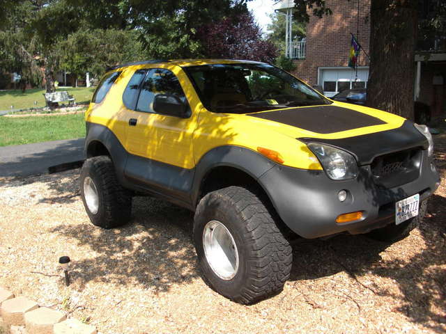

    The tires do stick outside the cladding an inch or so. Not enough to look silly(for you Tom), but enough give it that wider more aggressive stance.
    Yes, you can adjust the steering stops to minimize rubbing. Page 2A-16 in the shop manual. Fairly easy to do. So even if you do get rubbing, you can just set the stops to make it go away.
    I"m running a backspacing of -6 on a wheel that's 18x8.5 at stock height and I love the look...had to do some minor cladding trim front and rear, but no rubbing issues lock to lock and I have about 1" of tire outside the edge of the cladding.

    The picture of the Proton with the 'offset from hell' is mine. Wheel/tire protrusion is purely a matter of taste so do what you feel is right for you.
