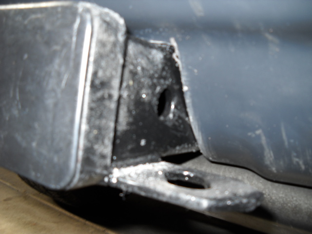

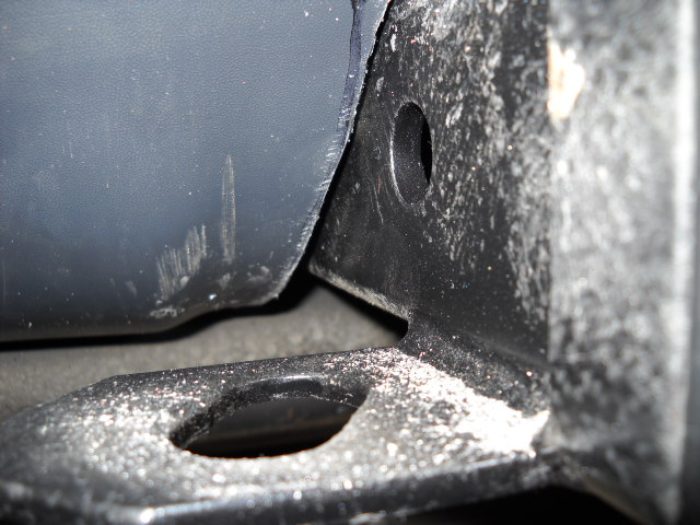

    A few issues that came up:

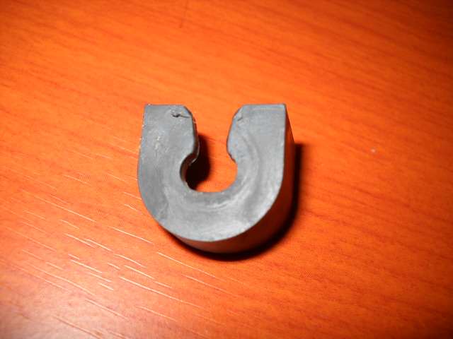

    I broke all but one of the Christmas tree holders. In addition, where these mount to the inside of the cladding one of the holder housings broke off. Anyone know what type of adhesive works on our plastic cladding so I can reattach this?
    The holes on the hitch did not line up with the holes in the frame so I had to drill all of the holes. In additon, the holes in the backplate were too high for the holes that I drilled in the front so I had to redrill those as well. I mounted the hitch as high up as it would go and still the backplate just didn't line up...
    I used a piece of notebook paper and made a heavy crease fold (90 degree) and l put half behind the frame and half on top with the crease snug on the corner. I then felt for, and rubbed through the paper the holes on the backside of the frame. I marked with a pencil the top edge of the paper. I then refolded the paper, so the dimples rubbed in the back now draped over the front, lining the top edge up with the pencil mark and the fold snug with the top front frame corner. Drilled the center of the dimples = perfect alignment.

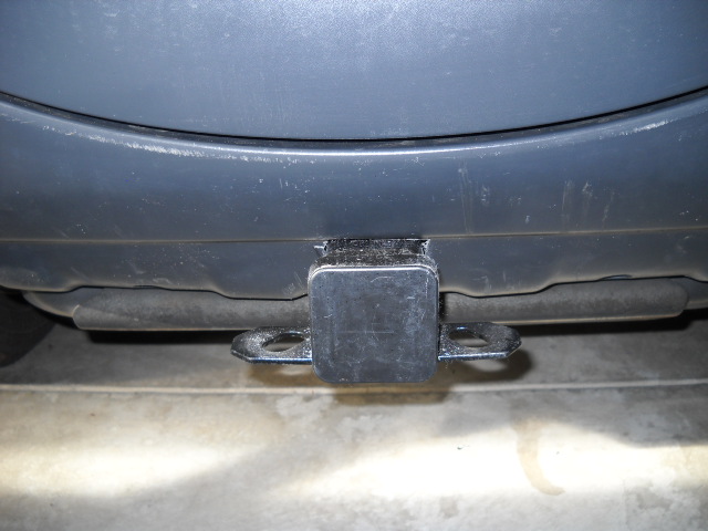

    Completed Project
    Thanks for all of the help...
    Still needs a good wash and clean up...but it's been a bit brisk here...
    Here's a tip: Make sure you have your cladding on something soft when you lay it down and when you are cutting the notch for the hitch so the edges dont get all scraped up. Do not ask how I know this...

    ...where these mount to the inside of the cladding one of the holder housings broke off. Anyone know what type of adhesive works on our plastic cladding so I can reattach this?
    Sounds like I'm too late with a response but here it is anyway.
    I broke off one of those tabs too. I used PC-7 to reattach the broken off piece. AFAIK it's still in place 2 years later.
    Hope that helps.
    Hope that helps.
    Thanks Tom.
    I put it back together without the tab after trying 4 different products. I'll get this at the ACE Hardware near my wife's work and put it back on.
