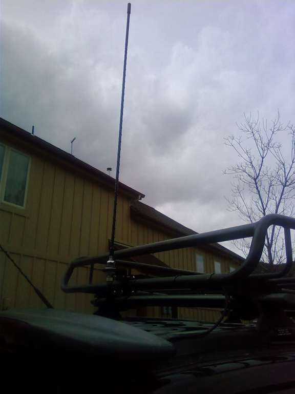

    mine is just on my roof bars with a drop down mount.
    UP
    DOWN
    Oh and an old clos up with a certain young lady without thedrop down bracket

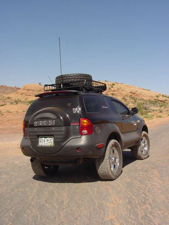

    Mounted mine to my roof rack with an antenna mount. Super easy to install and remove if you need to (which I do to get into my garage).

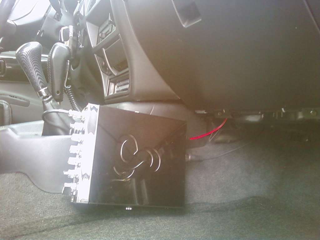

    I ended up zip tying the cable to my roof basket to get it over to the passenger side of the rear door. The cable then stretches over to the rear door and gets squeezed by the rubber around the door. Once inside I then tucked the cable behind the weather seal, drilled a small hole in the interior panel and then snaked the cable behind the interior panels to the passenger side kick plate, where I then fished it under the carpet under the passenger seat and under the carpet at the transmission tunnel, and finally poked it out behind the center console where it connects to the CB mounted to the passenger side of the transmission tunnel. Words are fine, but pictures are better:
    Cable zip tied to roof basket.
    Cable at roof basket and going to rear door.
    Cable tucked behind weather seal and small hole drilled in rear of passenger side interior panel.
    CB mounted to passenger side of transmission tunnel with antenna cable coming from behind center console.

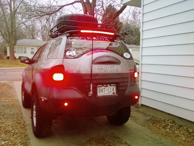

    Pics of the setup I had on my VX:
    Jan 2007
    *BHC* 1999 Ironman. :D 0454
    1,019
    Ram Air, how do you like that Cb Radio, is it a good one?
    Apr 2010
    1,673
    I liked it, it worked good for what I wanted it for and fit where I wanted it

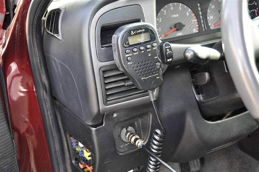

    I keep mine on the roof rack for optimum range. As for the radio, I HIGHLY recommend the cobra 75WXST. The guts fit just fine inside the ebrake console, and then you can remove the mic for theft prevention. Its also pretty cheap, and you can add the guts to other vehicles for like 35 bucks, and share a mic. I have two mics that rotate between the 3 trucks. (VX, RS and F250)

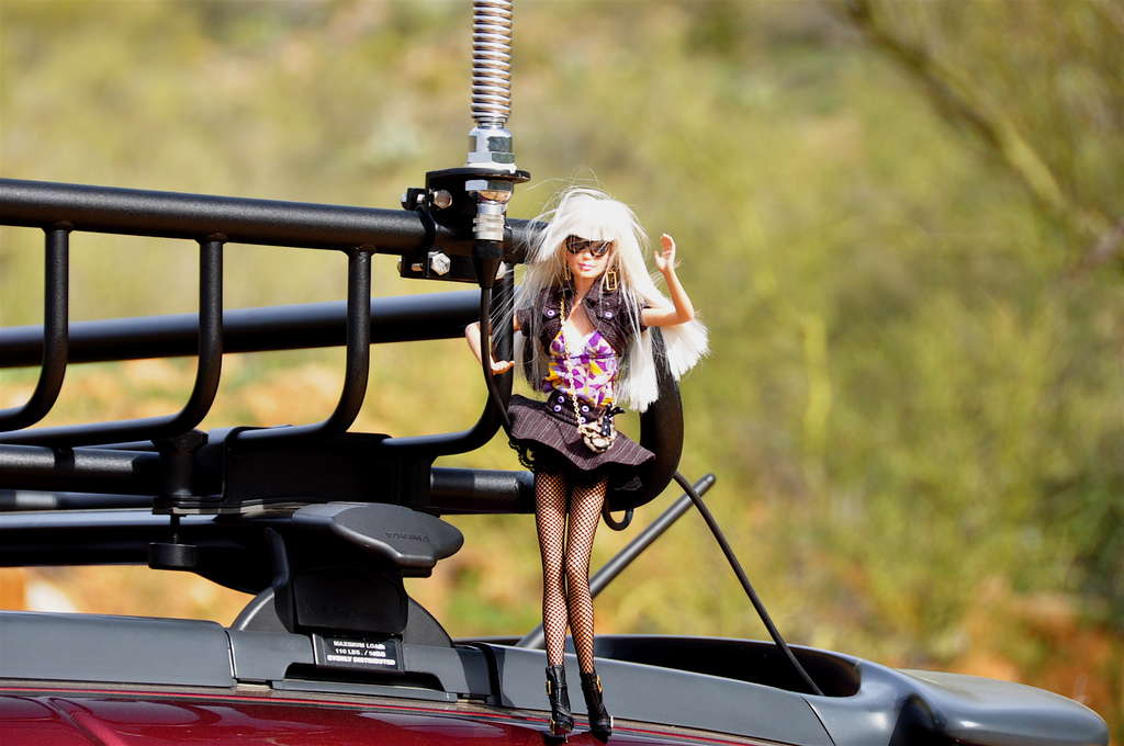

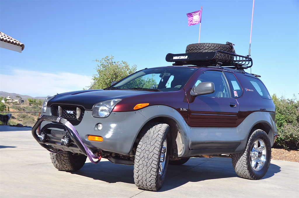

    Mounted mine on my Yakima roof rack, just like Mark did, except mines on the driver's side. And, yes, that is a Pink CB antenna!
    Had my handheld CB/mic combo mounted on the LEFT side of steering wheel, where the rheostat was.
    Hmm, why is it that 2 of us have a certain young lady hanging on our CB antenna???.....Oh, you were away for a while...have you been introduced to Jo's ORW?
