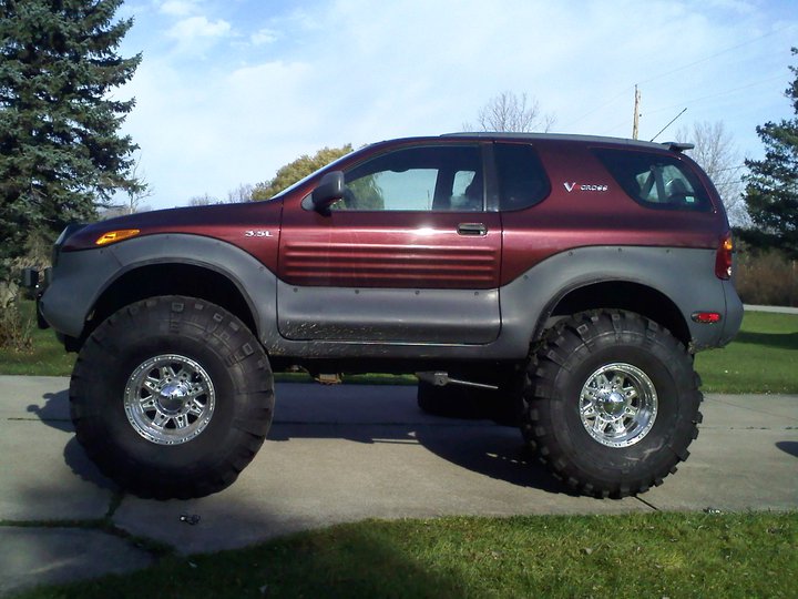

    I'd love to see a side view...
    A) How much cladding/metal you have cut out of arches..
    ..especially rear of front & front of rear ?
    or
    B) How much is going to rip off when those meats compress up into arches..
    I have all the plastic and even the pinch weld and lower fender mount removed. Just turning stop to stop they hit....may have to go down to a 38" swamper
    Its a tad top heavy/high center of gravity for my taste..
    ....but certainly eye catching
    here's the side view for now. Stuff is just bolted on at this point. I am not driving it like this. Still needs brake lines bled and my shock adapters from Independent4x installed
  7. #37
    Quote Originally Posted by superstang460 View Post
    Based on that photo, I assume you aren't going offroad in it. There is no way those tires can fit in the wheel wells,and we have like two feet of total wheel travel in the rear. No where for that tire to go.
    Jo-I was referring to the tops of the arches, I too have removed all that bracketing and plastic in the rear of the front arches. I still rub sometimes on the trails, but not enough to matter, just rubber on metal

  9. #39
    Thanks for the Side View Stang....
    A picture is indeed worth a thousand words!

    Nah, it will be alright! just get a big saw!
    OH, i've seen some hydrolic steering assists for Land Rovers for big lifts and tyres, you might need to look into something as you might find the steering box gives up with all the extra weight. Even a steering damper would help

    The VX is back together and rides better than it did with just the torsion bars cranked up 3" for my lift. I'm clearing 38x12.50 swampers on 8" rims and can turn stop to stop with no rubbing at all even close.
    Installed cross drilled and slotted rotors and new pads all the way around and it stops on a dime with the 38's. She's a little slow from a stand still start, but gets up to speed pretty much like normal. Its weird driving this thing and clearly seeing the roofs of minivans haha.
    Final setup.... FRONT
    Upper and lower front control arms with 5" of lift built in
    Indexed the torsion bars for about 2" beyond that for 7" total up front
    STEERING
    Sway bar extensions made
    Rod end steering links made and flipped on top to decrease angle
    4" diff drop with 5 degree rotation for perfect driveshaft angle
    REAR
    919 springs
    2" poly spacer
    2" drop of upper spring seat for 7" total out back
    1.25" length added to upper and lower 3-link arms to center rear wheel
    3" panhard bar drop
    3" body lift on top of that, for a total of 10" over stock.
