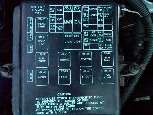

    If it is pronounced through the brakes, I too would tend to lean toward ABS, but then the light would be on. The fuse is under the hood, clearly labeled on the fuse diagram. That will have no effect on your vehicle other than no ABS and light on in the dash display. I pulled my fuse long ago...
    I was just thinking that if the ABS is 'confused' it may try pulsing the system whilst at a full stop, causing the vibration. It's a long shot but easy to check out by just pulling the fuse.
    That's great, but which of the two fuses is it (see question above)?
    pull them both or pull one then the other either way it tests the proposed problem. Have you given considerationof stopping by a brake place and letting someone wo can see and hear the problem make a suggestion? After all diagnosis by description is quite difficult . BTW dont rely on not seeing the light it may be burnt out.

    Which fuse is it? Looks like there are 2, one a 20A and the other a 40A:
