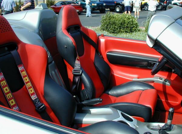

    2001 Black, Black, and more Black
    303
    They're not harness pads on the VX-O2/Mission To Mars.
    -Daver

  6. #21
    303
    Originally posted by Dallas4u
    Mmmm... LOVE that center console!
    It's got cupholders! Two of them!
    Enough said.
    hmm...the e-brake position and such is just like a BMW Z8 I was checking out tonight...
    -Daver
