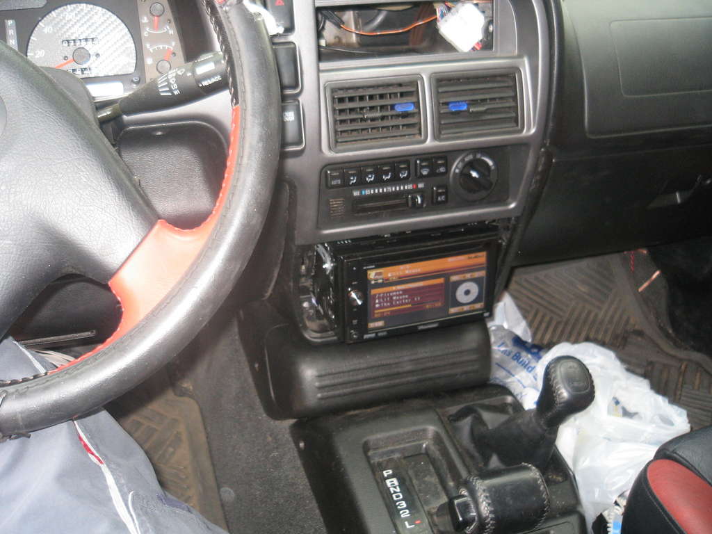

    Got the dash all back together now with deck and rear view camera installed, as well as the runs of wiring to the rear. I wound up using a relay to reverse polarity from the remote lead to trick the dvd player into thinking I am always in park I also installed a switch in one of the spare dash pop-outs which switches the rear-view camera on and off, rather than having to be in reverse. I went for a cruise and was surprised how wide the camera angle is. Really helps with that big blind spot. . .

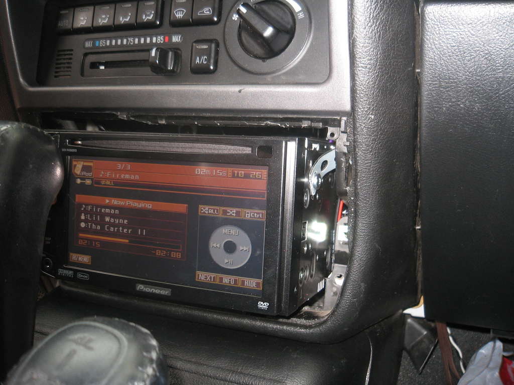

    Kenwood flip-out. Didn't know you could double-DIN???
    done and done...... and its theft proof because as long as the keys are out of the ignition, the gear selector is locked in 'park'....
    no way to get the radio out with the gear selector in park

    I've got to be honest, that looks like trash! Is there no way to make it look finished?
