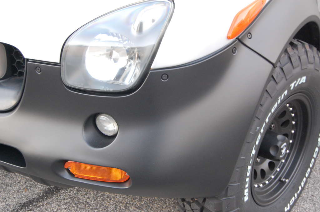

    Quote Originally Posted by WHODEY View Post
    Hello All,
    Can anyone out there tell me what size of wheels and tires i can put on my Vehicross without lifting it?
    I want to put some mud tires on it and need to know how big i can go.
    Thanks,
    WHODEY--- If you plan on using 16" wheels and are focused on getting M/T (mud tires), then please seriously consider the info below as it will make your VX look very impressive without lifting. If mounted on aftermarket wheels, the tires will likely rub and require some creative cladding trim. If mounted on the OEM 16x7 Stock Rims, they should fit bolt-on perfect with very little or no trimming.
    LT285/70R16 (31.71" O.D.). Pick this wide 285 series tire if you want an M/T type tire, in which case there are only two(2) tires made in this super-rare size (Toyo, Open-Country M/T and Nitto, Grappler M/T).
