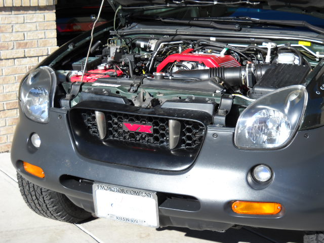

    I also found a guy on ebay who makes the VX logos for the front grill... they are 3-D like the vehicross logos and are available in a bunch of colors.
    Great quality!
    Just paste this item #260566055532, into the search on ebay motors. $10 + shipping....
    There's another seller of VX emblems on ebay, many of us have bought from him. He owns a Vehicross too. His are a little different than yours, has more CF choices and has a nice faux brushed stainless steel.
    He doesn't seem to have any on ebay right now, but he has them on his website: Or you can contact him and he'll list some on ebay. They're a bit more expensive than the other seller.
    http://svx-motorsport-accessories.st....net/veac.html
    http://svx-motorsport-accessories.st...jdmstvxem.html
    I got the faux brushed stainless steel.
    Here are mine from the same guys Kat
